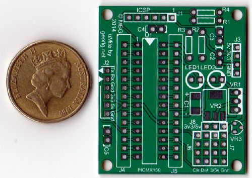

Gday Lads,
The MuP (Mick's uMite PCBC) PCBs have just arrived.. and I must saw they look excellent.
Now the big build and smoke test.. Although I have gone over it many times and not found any tracing problems, you never know.
I have decided that costing will be $3 per PCB and shipping is $1 per order in AUS and $3 to most other countries. This freight would allow about 5 PCBs to be sent in a standard letter with no insurance. Payment is via paypal (or beer), or cash if anyone has any these days.
Each PCB weighs 7gm and an air mail letter is supposed to be 50gm or under at that rate (and goes up on a logarithmic scale over 50gm). It would be cheaper to send 2 lots of 5PCBs if you needed 10 PCBs.
I will keep you posted on how the build goes.

Errr Mick, what's that brown thing next to the board in the photo?

  BobD said   Errr Mick, what's that brown thing next to the board in the photo?
I'll hazard a guess and say an 18c coin afterall the rest goes in tax's.......
It is supposed to be GOLD (AUS $1 coin) but you are right with the way tax and utility charges are going here it is worth a lot less but then the physical size is still the same so for size comparisons it is still valid.

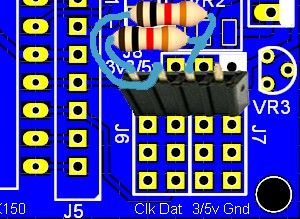

If I get another batch done I will try to add pullups for the I2C, They are missing on the one on offer now, not that it is a major problem.

  Quote  If I get another batch done I will try to add pullups for the I2C, They are missing on the one on offer now, not that it is a major problem.
That would be ok for low speed I2C but if things change and higher speeds are catered for, lower values of resistors may be required. I use a 4 wire bus and plug in the appropriate resistors on a spare header on the bus.

If you add fixed pullups they will interfere with using the I/O pins for general duties (ie, non I2C).

Hmm,
Thanks Mobi, Geoff,
Both good points.. I knew there was a reason I forgot to put them on the PCB..
Excuse the bad quality picture but I had as one option something like this on one of the sets of 4 pins I assigned for I2C. I intend to do a proper photograph of one to include in the manual (Well Maybe closer to documentation than manual) but I think the idea is clear enough.
The only other thing I thought of was a possible 1k resistor on the RX console if a 5V TTL adapter was used but even that there are times when you want it and times when you dont. It is not hard to add a resistor to your cable if you need it..

Still looking at how I'll connect my UV exposure box project with it (it's only been a couple of hours) but here are some quick thoughts for V2 if you're doing it.
1. Pullups could be optional via jumpers or solderlink.
2. Same for the 1K resistor on the pin12 Rx line in.
3. Putting all connector headers and the PIC on a 0.1" grid would make using it with proto boards a doddle - the components don't need to be on the grid.
