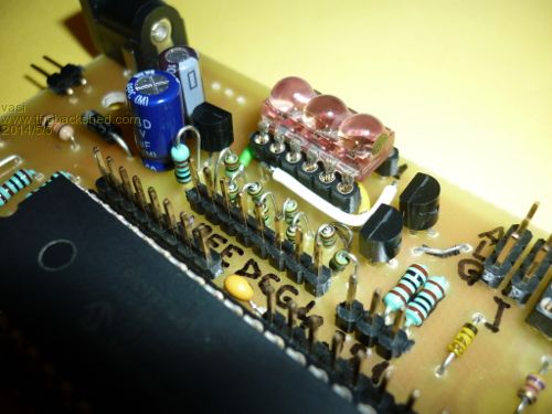

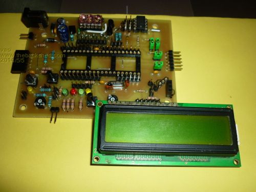

It is a home made 100x75 mm single-sided development board designed to put the PIC18F46K22 on a trial to see how it behaves compared to a Sanguino board. It is still on a "almost ready" state but can be used as it is. I chose to have it instead of a "Sanguino breadboard" style board which, together with a big breadboard would have occupied a lot of space on my small office.

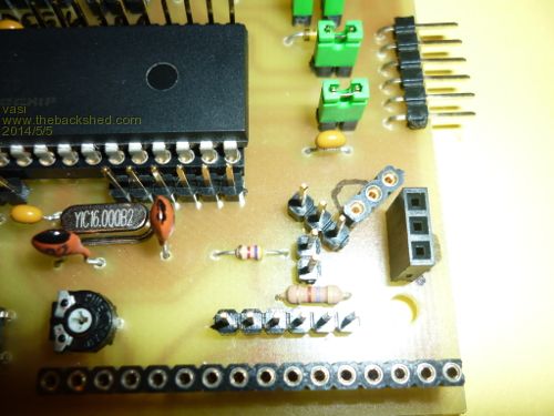

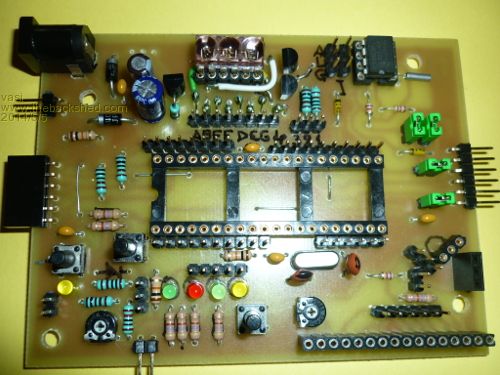

It is still missing a 7805 regulator (it powers from USB-to-Serial adapter), a 5v1 Zener diode protection for a resistive divider (measuring up to +55Vcc but is ok if I don't get close to the maximum voltage) and those two trimpots are just for show (not soldered) as they are 100K instead of 10K - one is for testing the ADC, the other is for LCD contrast.

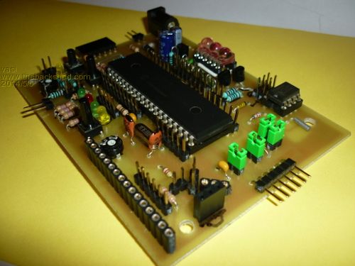

It has a PCF8583 as RTC (not tested yet) with two jumpers for 4k7 pull-up resistors and a smd battery socket bellow the board, a serial connection (Arduino standard) with a jumper on VCC and the another on the automatic reset function (which is not used by the actual bootloader, a modified AN1310 serial bootloader who needs a button to enter in boot mode):
The taller 3pin female connector (Arduino socket style) is to accommodate an interchangeable IR decoder (for 36, 38 or 40 KHz) and the smaller 3pin female connector is for a Dallas temperature sensor. The longer female connector is for 16x2 LCD display:

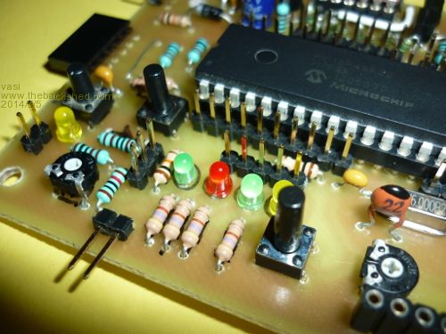

There are 2 user buttons, 4 user LEDs, a trimpot for ADC testing, a resistive divider for measuring external voltages, an ICSP connector (the black horizontal 6pin female connector):
12 years ago I recovered from a vintage computer board this Bubble Display (3 digits 7 segment) which I had no immediate use for it (not even curious to see the pinout), with the code "HP 5082 7433" It was hard to fit into such a small space and a single-sided design but now is ready to be stressed (datasheet here - and here, you can find a 4 digits one on ebay):

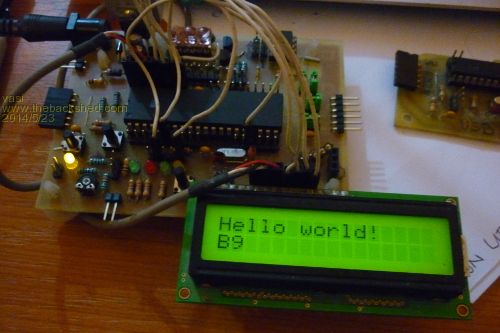

Posted: 06:09pm 22 May 2014

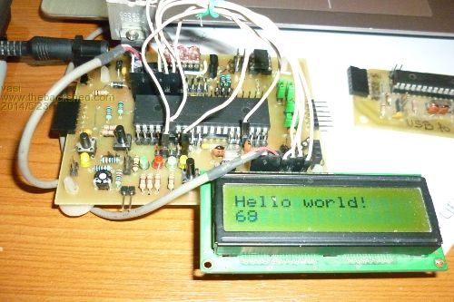

Pretty messy, but it works. It is a JAL LCD example which come with the standard Jallib package.

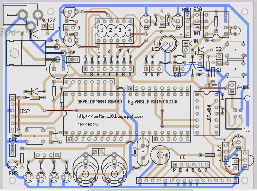

Posted: 01:45am 21 Jan 2015
The four digit bubble displays may be found at Sparkfun.
And my board may look like this at some point in the future...
And it may include:
- 1x4digit bubble display,
- 1 2x16 LCD
- 1 RGB LED
- 1 PCF8583 (external battery)
- 1 I2C bus
- 1 1wire bus
- 1 DS18B20
- 1 IR receiver (36,38,40KHz)
- 4 LEDs
- 2 user buttons
- 2 10K pots
- 1 resistive divider for real life voltage measurement
- 1 USB_to_Serial with PIC16F1454
