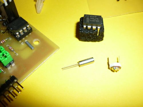

The I2C on MSSP1 works well on 100KHz and 400KHz bus speed but on 1MHz speed, after a few succeeded data exchanges, the firmware freezes. I'm testing it with the PCF8583 RTC (and JALv2 compiler with Jallib I2C master hardware libraries) but there is a problem: the 32KHz crystal is way off, as I get 2 hours advance on 3 hours run. It clocks way too fast! Maybe is the RTC at fault (I didn't looked at the datasheet to see if it sustains such a high I2C speed), and not the micro. So, this aspect remains to be solved another time. For me, it is important that the I2C works reliable at those two speeds. In fact, it will remain after night at 400KHz speed to see how it behaves on a long run.

I bet that the crystal is running on an overtone. I am not much of an expert on crystals but I understand that, if they are driven incorrectly, they will oscillate on a multiple of their proper frequency. It might be worth experimenting with the padding capacitors.

The data sheet I have lists the max I2C clock as 100kHz.
The date on my data sheet is 1997 so there is likely to be more up to date info available.
Setting the Chrystal trimmer is usually done by measuring the 1Hz output on the interrupt pin.
Values for the trimmer is likely to between 5 and 25 pF
Any value around those limits may persuade the crystal to behave itself.

The datasheet from 2010 is saying the same - 100KHz. It worked ok overnight at 400KHz but I understand this is above specifications and you don't usually do that. I restarted it at 0:00 and now at 13:50, the RTC shows 17:52 - that is how fast is running.
I bought a while ago the right crystal and another PCF (this one is borrowed from the Polish board) along with a trimmer capacitor, but I can't find them...
Anyway, this watch crystal served his purpose: helping me to port the PCF8583 libraries to JALv2 and to test I2C at different speeds. I have to build an I2C LCD to have at least 2 peripherals on I2C bus...

One thing that might be causing the problem is the type of X-tal used... The ones used in watches are made to be driven from very low voltage oscillators. The ones made foe RTC chips have higher voltage drive and could easily overdrive the watch types causing the odd harmonics problem...

I've soldered a 22pF cap. on VDD and OSC1 pin and it seems to behave normally. I'm querying it at 500ms on 100KHz I2C speed and it appears to be good. I'll do a test tonight. Or maybe sooner if I modify the firmware to allow me to set the time/date on serial...
_________
Edit: thanks guys, the capacitor cured the RTC problem.Edited by vasi 2014-05-11

Finally, I found the envelopes with the components! Now the AVR evaluation board can get her RTC back. But, I think I want to save the crystal for another project... Anyway, it would be there if something goes wrong again.
There is an obvious difference in size between crystals, that's why I had my doubts at the beginning.
