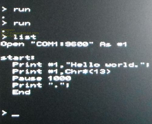

So, my current testing code is:
Open "COM1:9600" As #1
Start:
Print #1,"Hello world." + chr$(13);
Print ".";
Pause 1000
Goto Start
This just prints a dot on the screen for each loop, so I can just get an idea of how many times it has looped, and the Print #1,"Hello world." + chr$(13); DOES NOT suppress the CR/LF at the end of the line.

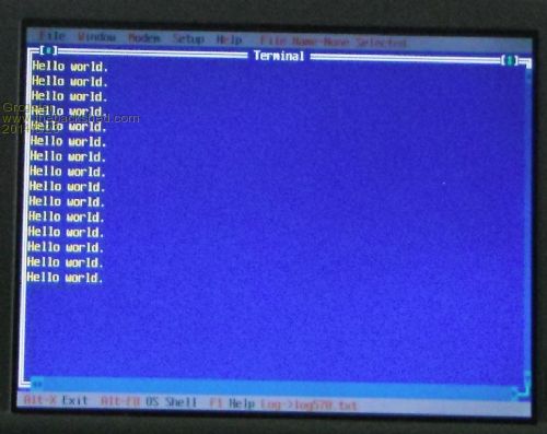

See this image:
Now, if I change the line in the code to Print #1,"Hello world."; then it works to a point - see this image:
Now, that IS correct, so if I change the code above to:

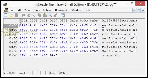

Here is an image from a HEX editor - I don't know what it means, but some of you will be able to work it out.
I captured this in TeraTerm, then opened it with TinyHexer.
UPDATE: If I send just ONE cycle of this to TeraTerm, having first set it up to log bytes, then the line Print #1,"Hello world." + chr$(13); outputs 12 bytes - just the message, and ignores the + chr$(13); completely.
If I change the code to the one where there is the ; on the end of the hello world message, and print #1,chr$(13) on the next line, I still only get 12 bytes - the message, with no CR or LF at all - code is totally ignoring the line Print #1,chr$(13);
The tinkering continues....Edited by Grogster 2014-05-24
Posts: 6615
Posted: 02:38pm 22 May 2014
It depends a lot on how you have your terminal program set up.
You usually have the option to automatically add the CRLF pair if only one of them is received.
That makes debugging your code difficult!
At first glance, your terminal program is seeing the CHR$(13) and adding the LF to advance to the next line. Without that, the CR your are sending will cause the line of text to be overwritten.
The HEX example you gave shows the text without any CR or LF which agrees with the 'hello world.' all on one line.

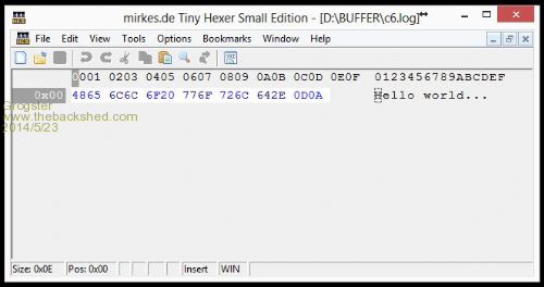

OK, here is another experiment.
Open "COM1:9600" as #1
Start:
Print #1,Chr$(13)
Print "."
End
This produces the following file:
Note that the line Print #1,Chr$(13) seems to be adding LF weather you actually want it or not...
Now, if I remark out that line(the 'Print #1,Chr$(13)' line), then I get the following output:
So, it looks like MMBasic is adding an unwanted LF byte there unless I am misunderstanding things, which would not be a first!!!! Edited by Grogster 2014-05-24

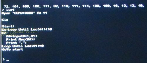

Posts: 10048
Posted: 04:22pm 22 May 2014
MaxiMite most definetly IS adding unwanted bytes to the serial output.
I have linked two MaxiMites togeather, and one transmits to the other, then the 2nd one reads out the bytes from the serial buffer.
Here is the "Sender" code:
...and here is the "Receiver" MM code:
Now, if I run the receiver code first(so it is ready for action), then run the sender code with the two MM's linked togeather, I get the following on the receiver MM:
Note that the MM is appending an extra CR/LF(13/10) to the end of the data sent out of the COM1 serial port on the first MM(the 'Sender')
So, in a nutshell, we have two extra unwanted bytes being sent, which is why the pager transmitter is replying with syntax errors - the transmitter is correct.
Can anyone think of a workaround for this?
BOTH MM units have the same firmware, which is version 4.4 - perhaps this is the source of my problems???Edited by Grogster 2014-05-24

Posts: 3368
Posted: 06:06pm 22 May 2014
  Grogster said   MaxiMite most definetly IS adding unwanted bytes to the serial output.
The line: Print #1,Chr$(13)
is missing the semicolon, this is why you are getting two extra characters.
The semicolon definitely suppresses the CR/LF.
Geoff
