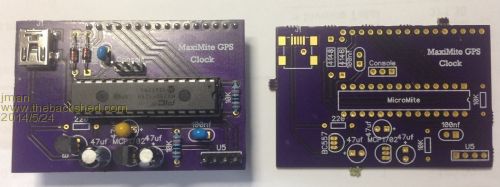

I really liked the GPS clock Geoff made to go with the Micromite
so I decided to make a little PCB for it that fits onto an LCD
The mini USB is only for power
I have attached the required files should anybody else want to do the same

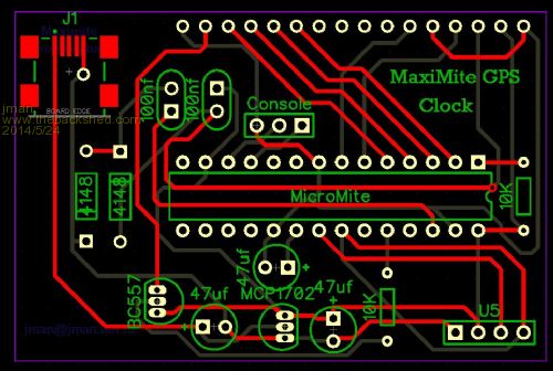

The PCB was done in DipTrace (PCB and Circuit attached

Looks Great Jman,
Is the PCB shown a different revision to the artwork?
Some parts look like they are in different positions.
PS. Are you selling the PCB?

  bigmik said   Looks Great Jman,
Yip the first revision had the curse of impatience applied :)
I had not planned on selling the PCB but I am more than willing to get a few made
If there is interest. I have attached the Gerber's for those who want to get their
own PCB's made
I had few arrive from www.dirctypcb.com and they look great and were really cheap
(The one in the picture is from www.oshpark.com)
