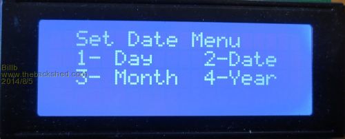

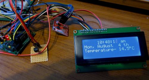

Hi All
This is my uMite version of a PICAXE clock is built some time ago.
The clocked uses a tiny RTC module from china with a DS1307 RTC Chip and a 24C32 EEPROM which I will use for the Alarm.
For setting the time and date, I use a menu system and IR remote.
As you can see, this is only a prototype using one of Big Mick's uMite boards and
a cheep AU$6.68 Chinese 4 x 20 LCDs

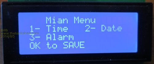

Menus

Menu: 'use IR remote to select menu items that are displayed on the LCD
keypress =255
LCD 1,1, " Main Menu "
LCD 2,1, " 1- Time 2- Date "
LCD 3,1, " 3- Alarm "
LCD 4,1, " OK to SAVE "
If keypress = Key_1 Then GoSub SetTime1
If keypress = Key_2 Then GoSub SetDate
If keypress = Key_3 Then GoSub SetAlarm
Loop Until keypress = Key_OK
gosub SetDS1307
Keypress = 255
LCD clear
Return

SetDate:
keypress = 255
LCD 1,1, " Set Date Menu "
LCD 2,1, " 1- Day 2-Date "
LCD 3,1, " 3- Month 4-Year "
LCD 4,1, " "
LCD 1,2, " Set Day 1 to 7 "
daycode = tempdata(1,7,daytemp)
EndIf
LCD 1,2, " Set Date 1 to 31 "
datecode = tempdata(1,31,dattemp)
EndIf
LCD 1,2, " Set Month 1 to 12 "
monthcode = tempdata(1,12,montemp)
EndIf
If keypress = Key_4 Then
LCD 1,1, "Set Year 2010 - 2060"
yearcode = tempdata(2010,2060,yrtemp)
EndIf
keypress = 255
LCD 4,1," "
Return

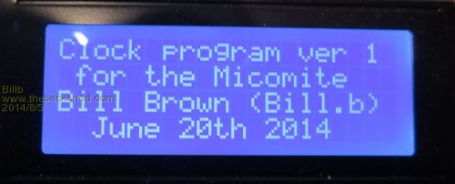

info:
do
lCD 1,1,"Clock program ver 1 "
LCD 2,1," for the Micomite "
LCD 3,1,"Bill Brown (Bill.b) "
LCD 4,1," June 20th 2014 "
loop until keypress = key_OK
LCD clear
return

OOps Just noticed the spelling error on the menu screen!!
Bill

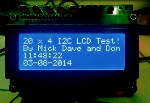

Hi Bill, All,
A little bit more comprehensive than my feeble test I did to test my new (PCBs are ordered, hope to have them in about 2 week) IO-Panel and 20x4 display.
Excuse the poor quality, it is a screen grab of a video clip I did and I tried to enhance it a bit to show the IO-Panel (You can just make out the LEDs above the LCD). The LCDs brightness made everything else look black. I might see how to upload these things to YooToob as everyone else does.

Lads, Lasses,
Hey posting on YooToob was easier than I thought.
Here are my two Vid Clips.
Backlight Control
Clock
