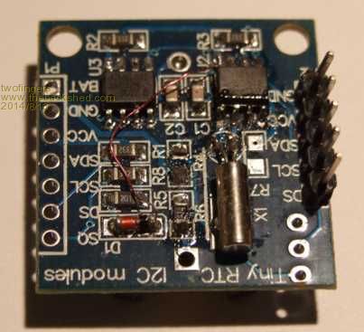

Hi folks.
As I am designing a custom PCB for my CMM based project, I was thinking perhaps I could use the likes of the 3231 extremely accurate RTC with internal crystal etc. These are available as I2C modules on the likes of eBay for only about $10 or so - cheaper then the chip by itself, and they usually have on-board button cell too. So, my question is, can I just substitute the 3231 for the 1307 and it's battery and crystal, and have a more accurate(over time) RTC? From what I have been reading, both the 1307 and the 3231 or 3232 use all the same addresses for time keeping, but there are battery-backed RAM address differences, but I have no plan to use those features of the 3231 - I just want it for the RTC. So, can I connect it where the 1307 would be, or are there special commands used with the 1307 that would mean I have to use that RTC? Smoke makes things work. When the smoke gets out, it stops! |

$10 is expensive. Look around I'm sure I paid around AU$5.00. Not at home so I can't check. Try DX.com as well as ebay. The last 3231 I checked went for several months I had trouble detecting the time gain or loss. As long as you stay at basic functionality of time and date the two chips are the same. I'm not in a fit state to read data sheets so I can't give you any more today. |

And if you get one with the eeprom (because it could be cheaper) here is the schematic: http://edwardmallon.wordpress.com/2014/05/21/using-a-cheap-3 -ds3231-rtc-at24c32-eeprom-from-ebay/ Cheers Don... https://www.dontronics.com |

All, Please, please beware of 'cheap' modules/chips. As many of you know by now I have had many bad experiences with 'cheap' parts. My main issue is with the current drawn - typically I find these 'cheap' modules pulling much more power than the data sheets show. For some of you this may not be a problem but ask yourself why are they pulling more power - and if so, what else do they do/not do properly? For an RTC, you would expect uS's in 'standby' so measure it as a precaution to ensure it is what it should be. Other 'cheap' chips have warmed up (almost too hot to touch in some cases!). All I am saying is be careful as often these 'cheap' chips are too good to be true. Another example, there is a global shortage of MX150's (TQFP) at the moment but I have had a Chinese supplier offer me 30 at £1.55 each. Should I buy these and use them in my 44-pin MicroMitres? NO WAY! Moan (& warning) over . . . .

You can do a drop in replacement and it should go fine. Here is my code for the 3231 that does the temperature and day of the week Jman's code for the DS3231 No alarms or offset Calculation to set Day of the week Goto settime from the console will set the DS3231 with the current time and date ' I2C RTC based On DS1307 Secs,Mins,Hours,Day,Date,Month,Year,Control Dim RTCbuff(7) Dim Temp(2) Dim Days$(7) GoSub Days i2caddr = &h68 ' DS3231 I2C address I2C open 100,100 ' Enable I2C I2C write I2caddr, 0, 1, 0 I2C Read i2caddr, 0, 7, RTCbuff(0) ' Read Time I2C write I2caddr, 0, 1, 17 I2C Read i2caddr, 0, 2, Temp(0) ' Read Temperature I2C Close BCDTEMP = RTCBuff(0) BCDtoDec BCDTEMP sec$ = Str$(decimal) BCDTEMP = RTCBuff(1) BCDtoDec BCDTEMP min$ = Str$(decimal) BCDTEMP = RTCBuff(2) BCDtoDec BCDTEMP hours$ = Str$(decimal) BCDTEMP = RTCBuff(3) BCDtoDec BCDTEMP DayOfWeek = decimal BCDTEMP = RTCBuff(4) BCDtoDec BCDTEMP day$ = Str$(decimal) bcdtemp = rtcbuff(5) BCDtoDec BCDTEMP month$ = Str$(decimal) bcdtemp = rtcbuff(6) BCDtoDec BCDTEMP year$ = Str$(decimal + 2000 ) t$ = hours$+":"+min$+":"+sec$ D$ = day$+"/"+month$+"/"+year$ Time$ = T$ Date$ = D$ Temp Print "Time has been set to ";Time$ Print"Date has been set to ";Date$ Print "Today is ";Days$(DayOfWeek) Print "Temperature is";Temperature End 'Temperature Sub Temp If Temp(0) < &h80 Then Temperature= Temp(0) + (Temp(1) / 256) Else Temperature=-((Temp(0) Xor &HFF) + 1) + (Temp(1) / 256)) EndIf End Sub 'Convert to Decimal Sub BCDtoDec (BCDTEMP) Decimal = Fix(BCDTemp / 16) * 10 Decimal = Decimal + (BCDTEMP And &hF) End Sub Days: For I = 1 To 7 Read Days$(I) Next I Return Data "Sunday" Data "Monday" Data "Tuesday" Data "Wednesday" Data "Thursday" Data "Friday" Data "Saturday" SetTime: ' Get time from time$ and date$ tempdec = Val(Left$(Time$, 2)) BCDtoHex TempDec hours = hex tempdec = Val(Mid$(Time$, 4, 2)) BCDtoHex TempDec minutes = hex tempdec = Val(Right$(Time$, 2)) BCDtoHex TempDec seconds = hex tempdec = Val(Left$(Date$, 2)) BCDtoHex TempDec day = hex tempdec = Val(Mid$(Date$, 4, 2)) BCDtoHex TempDec month = hex tempdec = (Val(Right$(Date$, 4)) - 2000) BCDtoHex TempDec year = hex DayOfWeek ' Write Time to RTC i2caddr = &h68 ' DS3231 I2C address I2C Open 100,100 ' Enable I2C I2C Write i2caddr,0,8,0,seconds,minutes,hours,dow,day,month,year I2C Close Print "0=ok 1=nack 2=timeout"; MM.I2C Print "RTC has been set to ";Time$;" ";Date$ End 'Calculate Day Of Week TZAdvantage's DOW Calculation Sub DayOfWeek A = Int(14-Val(Mid$(Date$,4,2)))/12 M = Val(Mid$(Date$,4,2)) + 12*a - 2 Y = Val(Mid$(Date$,7,4)) -a D = Val(Mid$(Date$,1,2)) Dow=(day+y+Int(y/4)-Int(y/400)+Int(31*m/12)) Mod 7 End Sub ' Convert to Hex Sub BCDtoHex TempDec hex = Fix(tempdec / 10) * 16 hex = hex Or ((tempdec / 10) - (Fix(tempdec / 10))) * 10 Return Regards Jman |

Thanks for those replies, guys. @ WW: I note your comments with respect to cheap modules. Perhaps it would be a better idea to design the 3232(or 3231) into the main-board with it's own battery holder etc, over using a cheap module. These are base-station PCB's, so I only need a few of them, so even if the 3232 is much more expensive by itself, it WOULD be a genuine part. Many of those cheap modules will be using IC clones. Food for thought... Smoke makes things work. When the smoke gets out, it stops! |
