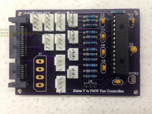

Hi
My Son got a new Motherboard for his PC and decided to add a new case and water cooling while he was at it. This lead to him purchasing some new high quality fans. the fans he purchased were 4 wire fans (PWM controlled) but the new motherboard controlled the fans via voltage not PWM (Except for the PCU Fan) so time to breakout the Micromite and make a Voltage to PWM converter.
This what I came up with it is installed in the new PC and working like a charm
I used a SATA connector for the power as this has a 3.3v to power the Micromite.
The basic program is attached. The PCB will fit into a 3.5' hard disk bay so it can be mounted easily.
Excuse the stupid type O (PMW)

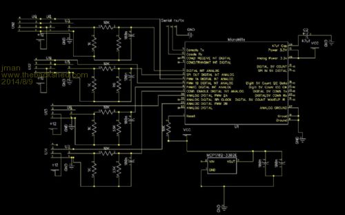

I have had a quick look at your circuit (in zip file) and also at the photo above. I understand everything in your photo on the right hand side from the two sets of 4 white connectors. However, can you quickly clarify a few things:
I assume the SATA connector is the black connector on the left hand side?
What is X1 for?
Are the three white connectors (1+2) above X1 for the voltage inputs? If so then why not four?
Sorry if these seem like silly questions; especially as you have been working on this for a little while. Like I say, I just glanced at it and have a use for something similar and hence the real interest.
Thanks for posting your project . . . . .

X1 is there if you want to use a normal Molex hard drive power connector
you will also need to fit the 3.3v Regulator
Yip the SATA connector is the black bit on the left (Through hole version)
The voltage inputs are the 4x 3pin connectors the outputs are the 7x 4pin connectors
Channel 1 has 3 outputs
Channel 2 has 2 outputs
Channel 3 and 4 have 1 output each
The 4pin connector closet to the 3pin connector also supply's the tacho pulse

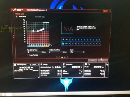

what brand and model was the mother board that your son used?
have you considered putting a usb connection to the board and permanently wiring it back to the PC to allow setting the fan speeds via Tera Term or other?

The motherboard is an Asus Maximus VII Hero
It came with a real nice GUI application that controls the fans
so he using that to talk to the Maximite etc..
Screenshot below

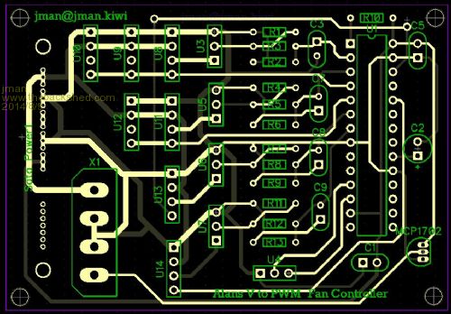

Took a quick look at the zip file and program. Very cool! What program do you use to do your pc boards? Also in line 13 (not including blank lines) of your code it says
PWM 2, 25000, 10, 10
should that be PWM 1,25000,10,10? or am I not getting it?
Again, nice unit!
@ Viscomjim
Well spotted "You are getting it perfectly"
It should read "PWM 1, 25000, 10, 10 "
That brings the fans down to dead slow after the initial spin up
I use DipTrace for my PCB's
