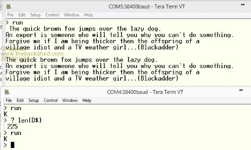

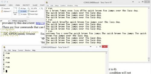

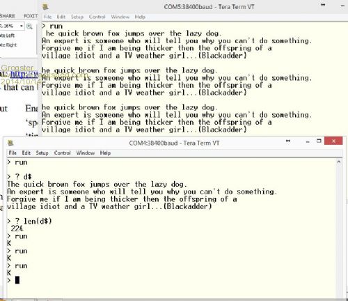

  Geoffg said   Hmm, a couple if things.
Firstly, you do not need to do a "Goto InitializeVars" initially. Executing VAR RESTORE does not generate an error if there is nothing to restore. So you could replace "Goto InitializeVars" with "IF CpuSpeed == 0 THEN InitializeVars".
Of course. I just wanted to be complete so others could reproduce the problem.
As with all the "Saved Vars" one really only has to do them once, or at least only when they are changed. In this "Testing" phase I needed to be able to quickly change them, more or less, on the fly.
  Quote  But the real problem is the I2C issue and your program makes it impossible to identify just what the problem is. It requires the tester to setup a test hardware with LCD, etc then reverse engineer your program to understand what is going on.
Actually, the LCD part is not failing at all, except when passed bad parameters.
Just comment out, in the Slave Program, Lines 8, 9, and 26, the 3 lines that operate the LCD.
All data that would be sent to the LCD is echoed to the console so I can see what is going on.
I'm running TeraTerm with a single RS-232 to USB interface. I added a DPDT switch in the RS-232 lines so I could easily switch between the Master & Slave consoles. This works well as I can quickly program each uMite and monitor their consoles.
I formatted each uMite output to the consoles so both Master & Slave data line up. This way it is easy to compare the two outputs.
  Quote  You need to distil it down to a dozen or less lines that demonstrates the issue without requiring unnecessary hardware.
Ok, The problem is almost certainly in the Slave lines 20..29. This is where the I2C bytes are being caught from the bus.
I'm using an I2C sniffer, that cool tiny scope by Gabotronics called the XProtoLab to monitor the I2C bus. Every byte the Master sends is correct in every detail. Therefore, I think the problem must be in the Slave interrupt routine.

Posts: 10048
Posted: 06:23pm 13 Oct 2014
Working at 400kHz with a string 224 bytes long.
MASTER:
[code]
I2C open 400,100
EOL$=Chr$(13) + Chr$(10)
DA$="The quick brown fox jumps over the lazy dog." + EOL$
DB$="An expert is someone who will tell you why you can't do something."
DB$=DB$+EOL$
DC$="Forgive me if I am being thicker then the offspring of a" + EOL$
DD$="village idiot and a TV weather girl...(Blackadder)"
D$=Chr$(85)+DA$+DB$+DC$+DD$+EOL$
For X=1 To Len(D$)
I2C write &B1010101,1,1,Asc(Mid$(d$,x,1))
I2C read &B1010101,0,1,B 'Wait for slave to acknowledge byte
Next
I2C write &B1010101,0,1,27 'Send end-of-data byte
Print Chr$(B)
End

We're always missing the first byte of the message - not sure why at this stage, but if it was consistent, then a dummy byte could always be used for byte one.
EDIT: I have fixed the missing byte one, by adding a capital U to the start of the data string, as a data-slicer sync kind of thing. No missing characters now.
Edited by Grogster 2014-10-15

Posts: 10048
Posted: 12:41pm 14 Oct 2014
Will experiment with that idea today.
Any idea why I should need the capital U sync byte to make my code work?
Is there an internal I2C data buffer in the uM and if so, what is it's size?
There is mention of the I2C bug that is known about. Can someone link me to that, so I can read about it. I remember reading in posts about the bug, but never bothered to actually read up on what the bug was.
