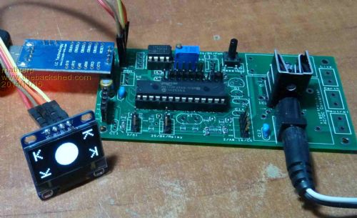

hi i can report first steps for i2c oled and mk2
Mk2 I2c Oled
oled switches on and show some random pixels from the memory inside the module.

Keep it coming!!! Make it draw some cool shapes and throw some text in there....

Plasma - You SUPERSTAR.
That is EXACTLY the module I am after to get working with a MicroMite. This thread now has my priority attention.

Got one working will post full code and details tomorrow

great ! the display supports also the 400 khz mode from i2c.
i see math has implement much moore functions as me , so i wait for his source , maybe we can
create some cfunctions for this oled.
cant wait to see your code matherp , are you sending the memory byte for byte or using an array ?
i think we can speedup the memory transfer if we use a 2kb array and store the "data"command every 2 bytes. after this a cfunction call grab the imagebuffer and split it also to the 2k memory.
now sending is easy because we have a array with data command and data bytes in.
i dont know what is faster , using this methode or changing the setpixel routine to create the same effect.
