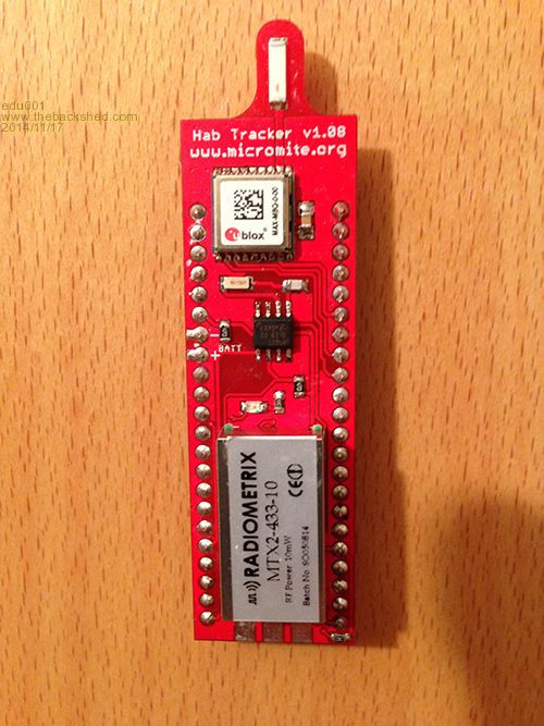

Just finished this HAB Tracker for the MicroMite
First test flight this weekend

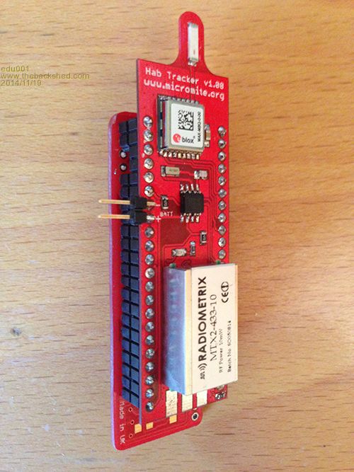

paceman is correct I use it for High Altitude Ballooning but it could track rockets/model aircraft ect
It uses a 10mw licence free transmitter on 434.xxx Mhz to transmit DATA (there is another post on here that details one of the prototype test flights)
The power supply is a single AA/AAA Lithium with a very efficient (94%) 3.3v step up regulator, I am testing one now with an AAA its on 60 Hours so far
To get the endurance the RTC puts the CPU to sleep in between transmits and disable every thing I don,t need on the GPS
In sleep mode it draws just less than 6ma

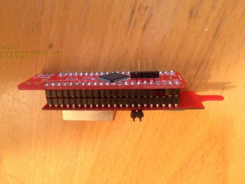

maybe its just me, but where is the uMite?
paceman
Joined: 07/10/2011
Posts: 1329
Posted: 01:28pm 18 Nov 2014
Doesn't look like there is one on this version Jim but there was one on the last version here: MM rocket.

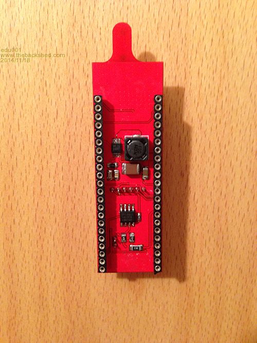

Ahhhh... it plugs into the ultra mighty ww44 pin unit. Very Very cool!!!! I would be interested in knowing what the gps unit has for an antenna on that board...Edited by viscomjim 2014-11-19
edu001
Joined: 14/07/2014
Posts: 82
Posted: 12:02am 19 Nov 2014
  viscomjim said   Ahhhh... it plugs into the ultra mighty ww44 pin unit. Very Very cool!!!! I would be interested in knowing what the gps unit has for an antenna on that board...
Indeed it does viscomjim the GPS antenna is the small white SMD chip on the top
