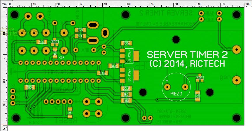

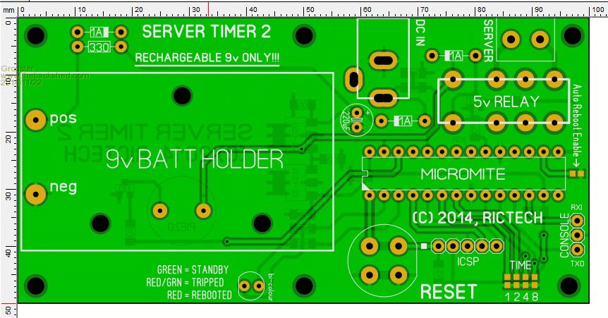

So, I decided to come up with a Micromite powered alternative:
TOP LAYER:
BOTTOM LAYER:
This board is already produced, so there is no design-by-committee issues with this one!!!!!
The main advantages of this idea are:
- It does not need software to act as an intermediary
- It does not care one jot about computer type
- It will work with Windoze, Mac, Linux, BeOS, Unix... anything.
- Adjustable timer time between 1 and 15 minutes
- Can automatically re-boot the computer(some BIOS's don't let you do that)
The concept is pretty simple. The unit trickle-charges the 9v rechargeable NiCd battery, which takes over powering the circuit(via a diode gate) if the juice fails. Please, no comments about the most basic of basic charging methods - it works, and works well. Although constant trickle-charging like this will technical kill the battery quicker then a delta-V monitored arrangement, it will take several years. It is important to note at this point, that I am using NiCd rechargeable battery, NOT a NiMH or Li-ION type - they do need a more advanced charging system.
The Micromite monitors the incoming 12v power by way of a potential divider formed around a 10k and 3k3 resistor. The unit is powered normally by an external 12v plug-pack plugged into the NON-UPS side of the power. When the power fails, so will this 12v supply, which the Micromite will detect. This starts the timer, and once the set time has elapsed, the unit will close the relay contacts and shutdown the server.
The relay contacts are N.O, and are connected in parallel with the system's main power button, simulating a power button press when the timer runs out. The timer has to be set in proportion to the size and backup capability of the UPS being used, such that the timer will time-out BEFORE the UPS goes flat.
In my case, I am using several NASLite-2 x64 servers which run from 64MB(yes - MB, not GB) USB flash drives, and although Linux based, they are NOT GUI based systems, rather HTTP-based, so you cannot install extra software as such. So I needed a way to be able to shut these down in the event of a power cut, but the UPS's I used only had Windoze software to do that.
If anyone is interested in a PCB, flick me a PM.

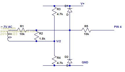

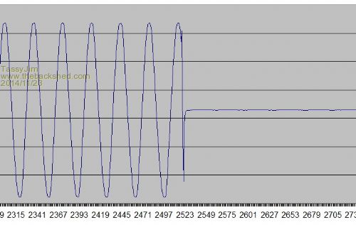

Many years ago (everything seems to have happened many years ago), I worked in the power industry and we have some wonderful old instruments. One I liked was a disturbance recorder. Whenever it was triggered, it would spit out a couple of metres of paper with a chart of the voltages and currents for a few seconds before the event and a few seconds after.
Last week I was sitting at the 'puta when there was a power 'disturbance'. I missed the pretty charts so micromite to the rescue.
The idea is to have one micromite continually reading the voltage and when triggered, spit the 5000 readings out to be analyzed.
A MX150 micromite can take 30 readings per 50Hz cycle and a maximum of 5000 readings.
That gives around 3 seconds.
If you trigger it 2 seconds after the 'event', you will end up with 1 second of pre-event and 2 seconds of post-event.
A MX170 can read a bit faster and store more samples.
I will end up triggering from a second micromite similar to Grogster's setup.
If you aren't interested in looking at the AC waveform, use a rectifier and a small filter capacitor then slow the reading rate down.
For the AC input I found an old plug-pack with AC out.
The chart is a portion of a test drawn in Excel.
DIM readings(5000)
SETPIN 5, INTL, snap
SETPIN 4, AIN
n=1
DO
readings(n)=PIN(4)
n = (n+1) MOD 5000
LOOP
END
SUB snap
FOR k = 1 TO 5000
PRINT readings((k+n) MOD 5000)
NEXT k
END SUB
There is no time for the micromite to do any calculations during capture but I am impressed with the quality of the waveform in Excel.
Now I have to wait for a real life 'disturbance' to capture.

Posts: 10048
Posted: 06:34pm 20 Jan 2015
As an update to this thread, here is the current working code for this unit:
'Server Shutdown Timer 2
cpu 5 'Run CPU as one-cylinder rather then a V8.
setpin 6,din:setpin 7,din:setpin 9,din:setpin 10,din:setpin 24,din
setpin 2,dout:setpin 3,dout:setpin 15,dout:setpin 16,din:setpin 26,dout
Pause 1500
T=0:E=1:B1=0:B2=0:B3=0:B4=0
if pin(6)=0 then B1=1:E=0
if pin(7)=0 then B2=2:E=0
if pin(9)=0 then B3=4:E=0
if pin(10)=0 then B4=8:E=0
if E=1 then 'No valid time set, so begin red blinking loop forever
do
do
pin(2)=0:pin(3)=1:pin(26)=1pause 125
pin(3)=0:pin(26)=0:pause 125:X=X+1
if X=4 then exit do
loop
pause 3000:X=0
loop
endif
T=(B1+B2+B3+B4)*60 'Build time delay
X=0
do 'Valid time period set, so blink green
pin(2)=1:pin(3)=0:pause 150
pin(2)=0:pause 150:X=X+1
if X=4 then pause 1500:exit do
loop
start:
do
pin(2)=1:pin(3)=0:X=0 'Green LED for standby
if pin(24)=0 then 'Mains power failure detected
do 'Begin time delay
pin(2)=1:pin(3)=0:pause 125
pin(2)=0:pin(3)=1:pause 125:pin(3)=0
if pin(24)=1 then goto start 'Mains power back again
pin(26)=1:pause 50:pin(26)=0 'Pip piezo
pause 700:X=X+1
if X=T then exit do 'Time's up!
loop
pin(2)=0:pin(3)=1:pin(26)=1 'LED red, piezo on
pin(15)=1:pause 1250:pin(15)=0:pin(26)=0 'Power down server
if pin(16)=0 then 'Auto-reboot blobs selected
do
if pin(24)=1 then pause 5000 'Wait for power to come back on and be stable
if pin(24)=1 then
pin(2)=0:pin(3)=1
pin(15)=1:pause 1250:pin(15)=0 'Power up server
pin(3)=0:goto start
endif
pin(2)=0:pin(3)=1:pause 50
pin(2)=0:pin(3)=0:pause 950
loop
endif
do
pin(2)=0:pin(3)=1:pause 100
pin(2)=0:pin(3)=0:pause 1000
loop
endif
loop
The unit is working beautifully, and I have it setup to reboot the server when the power comes back on and stays on for at least 5s. This delay is to make sure the power is stable before the attempt is made to reboot the server. Sometimes, due to start-up load on the system after a power cut, the power can be a little "Dirty" until all the load has settled on the network.
If the Auto-reboot blobs are not shorted, then once shut-down, the unit just blips the LED at you red, to indicate that it has shut the system down, and you must then press RESET and power up the server yourself manually.
As mentioned, this PCB and code will work with ANY server that allows pushing of the power button to shut it down safely, from cheap single-drive $50 things, to full-size corporate servers. PROVIDED you can shut down the server by pressing the power button and then releasing it - most servers do it this way, but I am guessing that not all on the planet will.
I have had this code running for about two months now, and have simulated several short power cuts, and full power cuts to test operation. Everything works as expected.
