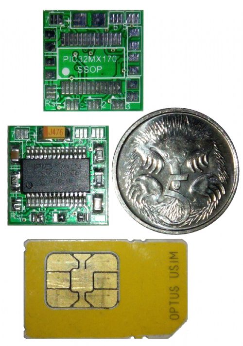

Hi All,
MuP-Mini has arrived from The PCB Fab house.
I am a bit biased but this board looks absolutely beautiful..
It is 15mm x 15mm square and is considerably smaller than an Australian 5c coin.
I havent yet completed the Manual for it so it will be a few days before this project is complete but I have successfully programmed and `flashed an LED' with it.
Anyway for what its worth here are the preliminary pictures of MuP-Mini with a 5c coin and a standard SIM for size comparisons..
I havent yet worked out prices but I am thinking along the line of
Bare PCB $1
Full Kit $9
Fully built $15
This is NOT an easy build, due to the component's small sizes but I am sure that those with experience with SMD will find it easy enough.
I, myself, lost a couple of resistors and a capacitor whilst building this one as they are so small (0805 SMD size).. The HUGE yellow blob is a standard 1206 size 47uf cap.
Anyway full details will be added when a complete manual is available and will be posted in my `Micks shameless self promotion' thread.
PS. Special Thanks to Grogster for suggesting this idea in the first place.

That is just ridiculously small. :) :)
I would like to have a go with a kit version.
The NanoMite is born.:)

Hi Bigmik, this is really an excellent unit. This might force me to get a reflow oven going. I was looking for an excuse for a while and this I believe is it. When will the boards be available?

More or less available now Jim,I am just finalising the manual but I will prefer that any one interested to read the manual so they know exactly what it offers before the big leap for a $1 PCB.

I use Solder paste and/or Gel Flux and huge magnifying lenses to do this baby.
