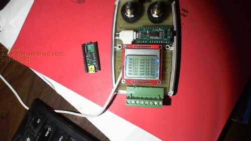

Good evening Peter
I was using you original library posted on 11-30 on my DIP-600-28 prototype board with a Nokia display and managed to get it working ok. I was changing the code around to take out the RTC and temp IC parts intending to replace those parts with the RTC-Fram IC code used on my board. When returning to the forum I noticed you had posted a new library update (awesome work!) so, I thought, after taking a look at it, why not start over and use the new code and start testing again... I modified it to change the display control pin numbers and tried running it...
The display doesn't display anything so I tried doing a "ctrl C" to stop it but could not get back to the command prompt. After a hard reset I turned on the trace (tron) and ran it again. The trace seems to get to line 192 and then just hangs up. The trace seems to point to the LCD.SCmd (send command) subroutine.
SUB LCD.SCmd(Comnd%)
local i
pin(LCD_cd)=0 ' Send this byte as a command
PIN(LCD_cs)=0
i=spi(Comnd%) <<< This is where the code seems to hang up >>> (line 192)
PIN(LCD_cs)=1
END SUB
I am not sure why this is happening... The only things I changed so far are the pin numbers driving the display. I am assuming that "rs" stands for the display RESET line and "cd" stands for the command/data line and the "cs" stands for the chip select or display select line...
I think the hardware is connected up ok since the older library post code was working correctly. I will have more time to fuss with things tomorrow after church... Now it's pillow time... zzz
Thanks Pete for your AWESOME work on creating this library..!!

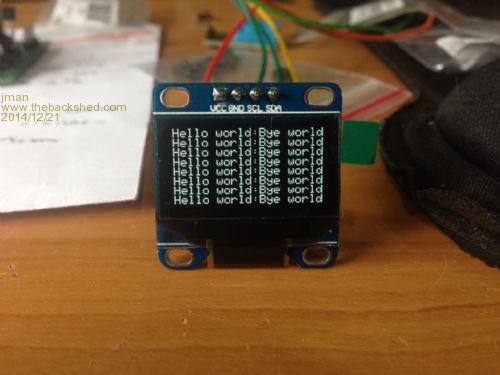

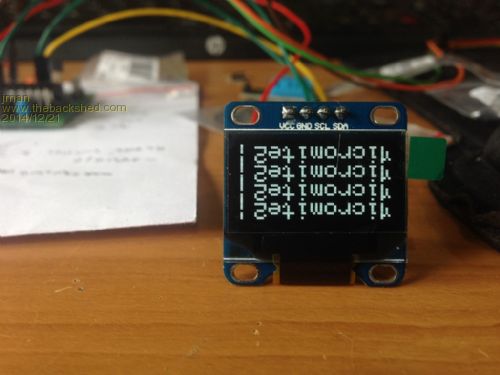

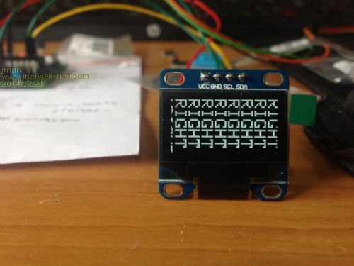

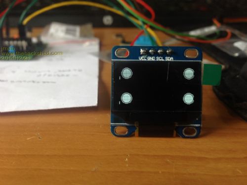

Hi
I have at last hooked my little .96 I2C OLED display (SSD1306 128*64)
The first screen is normal but the rest seem to be shifted to the right
pictures below to show the problem
Jman
Posts: 11901
Posted: 12:54am 21 Dec 2014
Jman
There is an offset parameter to the init routine. It is probably set to 2 in the example program. This is needed for the 1.3" OLED displays as they seem to be wired differently. Change the offset to 0 and the problem should go away.

Zonker
What version of the firmware are you running? My code for the Nokia was tested on 4.6b27. I haven't retested on 4.6 release and can't now do this until Tuesday but I expect it work work fine. There were problems with SPI pre b27 which Geoff fixed for me that related to the mixed use of the SPI write and x=SPI(y) syntax in the same program.

Posted: 04:10am 21 Dec 2014
OK...
I have updated to the new v4.6 firmware and all seems to be good..!
Thanks Pete..!
jman
Joined: 12/06/2011
Posts: 711
Posted: 08:36am 21 Dec 2014
  matherp said   Jman
Thanks for that worked a treat
Jmn

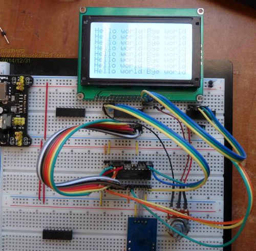

New file supporting standard KS0108 based GLCD. Note the use of DIL resistor packs to interface the 5V display to the MM
Fixed pin allocation is:
KS_RESET=14 'B05
KS_CS2=16 'B07
KS_CS1=15 'B06
KS_D7=26 'B15
KS_D6=25 'B14
KS_D5=24 'B13
KS_D4=23 'B12
KS_D3=7 'B03
KS_D2=6 'B02
KS_D1=5 'B01
KS_D0=4 'B00
KS_E=2 'A00
KS_RW=3 'A01
KS_RS=9 'A02
Use the Port/pin to map pin numbers to a 44-pin micromite if required
2014-12-30_200136_KS0108.zip Edited by matherp 2015-01-01

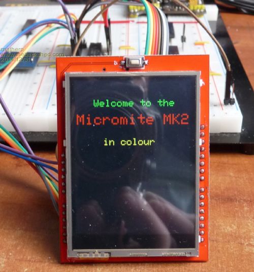

New version for ST7781 controller used on many 2.4" TFT displays (controller reports ID 7753)
2014-12-31_103644_T24BAS.zip
This version is only marginally slower but avoids using the Comm1 and I2C pins (I'm afraid the SPI pins are still used). the pin allocation is now:
T24_CS=2 'a0
T24_CD=3 'a1 (marked LCD_RS on the board)
T24_WR=9 'a2
T24_RD=10 'a3
T24_RESET= 14 'b5
T24_D0=4' b0
T24_D1=5' b1
T24_D2=6' b2
T24_D3=7' b3
T24_D4=23' b12
T24_D5=24' b13
T24_D6=25' b14
T24_D7=26' b15
Some things to note - this version does not work with the SPDF5408 based 2.4" displays. I've got one on order and will try and get this working when it arrives.
Also, please note the use of the resistive touch display is not supported. The touch displays have a resistance of around 300ohm and when "touched" this can reduce further. Based on ohms law this means even untouched at 3.3V they pull 11mA. This is at the very maximum the driving capability of the PIC32MX and causes the drive voltage to sag leading to inaccurate results. I'm going to try using a buffer chip for the drive and will report results in a new thread.

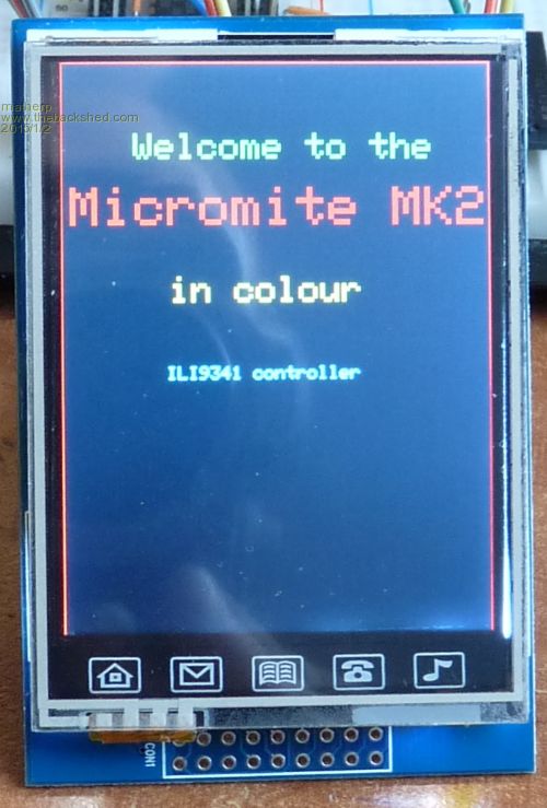

Posts: 11901
Posted: 10:59pm 01 Jan 2015
There are both 2.4" and 2.8" displays on sale that advertise they use the spfd5408 controller. Based on a sample of two, my 2.8" display and bigmik's 2.4" display, these actually use the ILI9341 or ILI9340 controller. This code works for both. There are also ILI9341 displays advertised but these use an SPI I/F. These are not supported by this version.
I9341_CS=2 'a0
I9341_RS=3 'a1
I9341_WR=9 'a2
I9341_RD=10 'a3
I9341_RESET= 14 'b5
I9341_D0=4' b0
I9341_D1=5' b1
I9341_D2=6' b2
I9341_D3=7' b3
I9341_D4=23' b12
I9341_D5=24' b13
I9341_D6=25' b14
I9341_D7=26' b15
2015-01-02_085904_ILI9341.zip

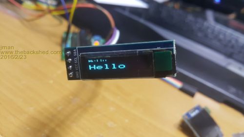

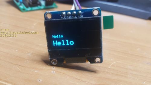

Posted: 10:48pm 22 Feb 2016
Hi
I wondering if the I2C code could be adapted for this OLED
OLED
It uses a 96x16 OLED with a SSD1306 - I2C controller
This the code I used
OLED.pstring(5, 32, "Hello", 1, 0)
OLED.pstring(5, 48, "Hello", 2, 0)
I have tried and it does work to a degree with font size 1
the display is perfect with font size 0 it is broken up
96x16 OLED
128x64 OLED
Many Thanks
