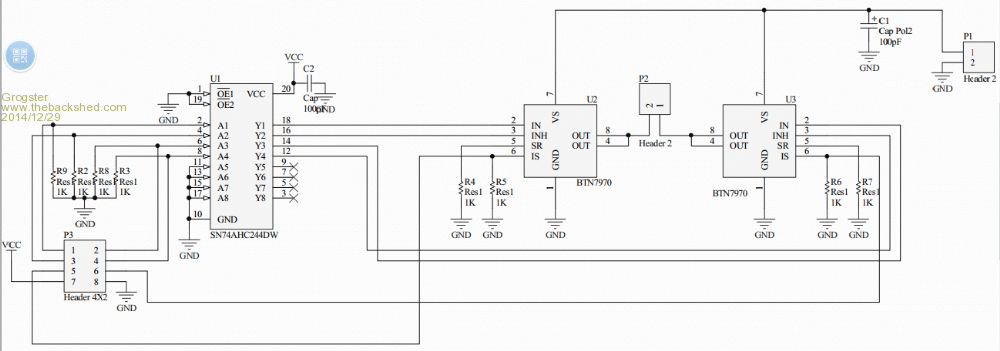

EDIT: Found circuit.
Based on that, it looks pretty easy to drive. Full MCU buffering via the 244 chip, so should be quite hard to kill it or the MCU by accident. Pull both enables high, PWM into one input will make motor go one way, PWM into the other input will make it go the other way.
Edited by Grogster 2014-12-30

@grogster if you need help with the german language come to germany :) or ask me ;)
btw i think it has in reality not much moore as 15-20 A.
Edited by plasma 2014-12-30
