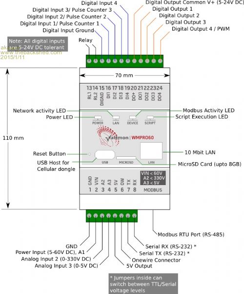

Wattmon is a monitoring and control platform designed to be highly flexible. It was initially conceived as a solar energy and battery monitor but it has evolved into much more thanks to customer feedback. I beta tested the product in 2013 in a tiny township in South India with die-hard solar enthusiasts and it grew from there - there's always a “oh, can you also monitor my…” And a “but I want to automate my ..”

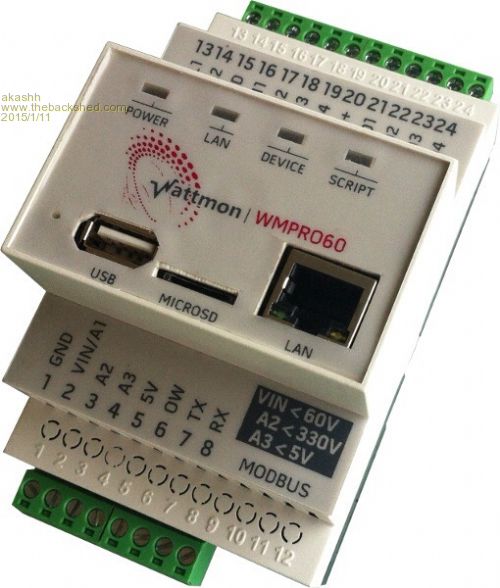

The Hardware
The product consists of a master unit (I just release a new version called WattmonPRO) which is the brain of the system. It runs on anything from 5 to 60v DC and is ideally directly connected to a battery bank. It has Ethernet, a USB host port that supports several cellular dongles for low cost remote monitoring, and an SD card for storage. An embedded web server provides a convenient responsive interface for all devices from smart phones to large screens.
Several onboard connectors make basic data collection and control easy: 4 isolated digital inputs, 3 of them with pulse counting let you hook up flow meters or other counter devices. 4 open collector outputs let you hook up SSRs or small relays to control things. A built in isolated relay can handle 5 amperes of current, ideal for powering a small load. On the analog side, the power supply voltage is measured through one channel. A second channel can read voltages up to 330v DC, such as a large high voltage battery bank. A third input handles 0-5v dc, ideal for a sensor such as a pyranometer.
The real power comes from the interfaces: an RS-485 port with Modbus-RTU support makes it possible to communicate with thousands of third party modules such as meters, relays and sensors. I created a few devices that cover most commonly required function such as isolated current sensing, analog inputs, relays, frequency measurement and PWM output.
The Rs-232 serial port can be used to collect data from pretty much anything. We provide drivers to Victron and Studer inverters but could adapt them to any serial inverter protocol.
And finally a onewire port makes it easy to add temperature sensors for monitoring and automated heating control.

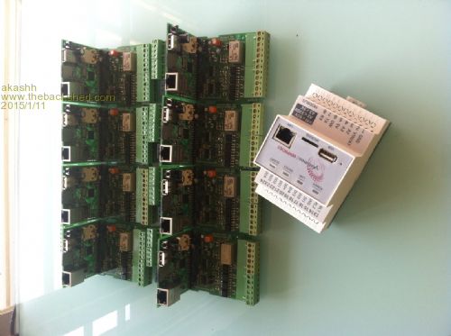

For the backshedders I will describe the internals a bit. A pic32mx795 processor runs a FreeRTOS based operating system which allows me to run up to 2 or 3 programs simultaneously. Memory is the biggest constraint and careful use of variables needs to be made or else a script will be terminated. Scripts are compiled (tokenizer) into a separate file the first time a script is run, and stored on the sd card. Scripts are buffered in RAM as they execute, meaning there is no size limit on programs, and include files can be used to combine different parts together, exactly like with PHP. An enc28j60 ethernet controller provides the LAN connectivity. A USB Host stack also supports certain cellular dongles, setting up a second network interface with PPP. This was lots of fun to implement, adapting the microchip tcp stack to support multiple interfaces. The usb stack also got modified to handle the required "modeswitch" for dongles, they first appear as SD cards and need to be reconfigured each time!

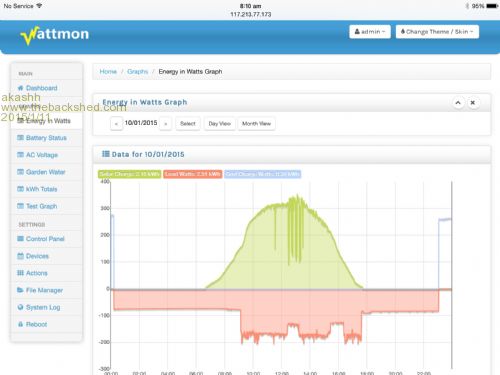

Here is a graph of daily solar production and load for yesterday, as seen on the iPad. This is generated from the webserver on Wattmon dynamically.
