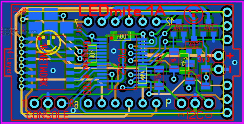

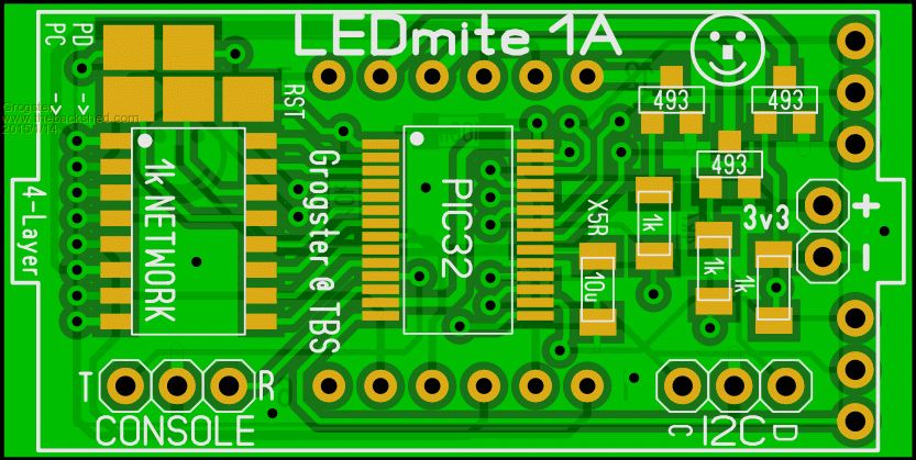

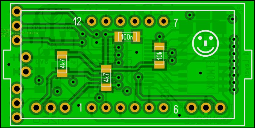

Hi folks.
Here is my latest mad creation.
LEDmite!
This is a full MicroMite MK.II on the back of a three-digit LED display. All the interfacing to the LED display is on-board, as are the console, I2C, PICkit3 programming pads, COM1 serial port, and a few other I/O pins that I could squeeze in.
Designed specifically to fit into those cheap LED panel displays you can buy on eBay for about $2.50 each. You pull the existing module out of the panel bezel, and fit this as a replacement - it just pops in where the original unit was.
The PCB is 41mm x 21mm, and is a 4-layer board.
Does not use the original LED driver or display - I'm just reusing the panel bezel and filter because they are so cute, and which makes the thing look a million bucks on any panel without you having to try to make the LED display look nice.
Lots of potential uses from voltmeters and ammeters, to speedometers, countdown or count-up timers, heart-rate monitors etc - you just need to change the MM code to suit whatever you are doing. Having a separate MM to drive the display, leaves your main MM free to concentrate on more important things. Having some I/O pins available, means you could easily build a timer that would trip one of those I/O pins to trigger something external if needed, or otherwise control other things when needed. No SPI interface, as I needed the pins to control the LED display.
The initial code will use I2C to talk to it(mainly cos of the MM's nice I2C interrupt handling when used in slave mode), but you could also use COM1 or even the console if you wanted - all up to you and your programming abilities and/or preferences.
Three digit, as that is what I needed at the time I started designing this thing.(in case some of you are wondering why it is not a four-digit unit)
LED digits are 0.56" in size(14.2mm), and are very easy to see from across the room.
Top Visible Layer:
Bottom Visible Layer:
All Layers:

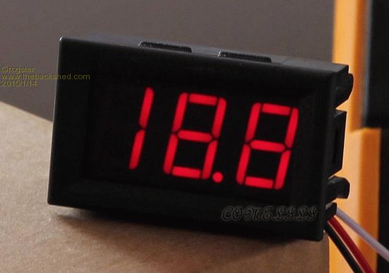

Image stolen from eBay of how display looks from the front:
This last image, is a mock-up, and not the actual unit, but this is what it will look like when finished.
