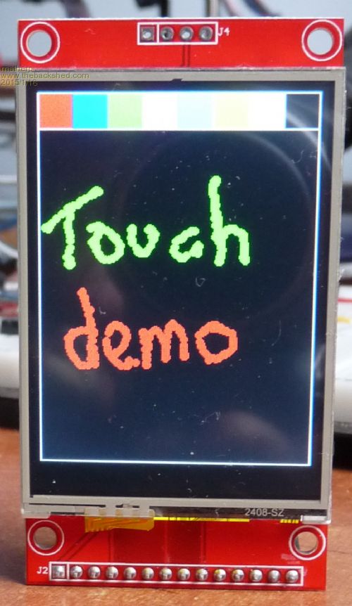

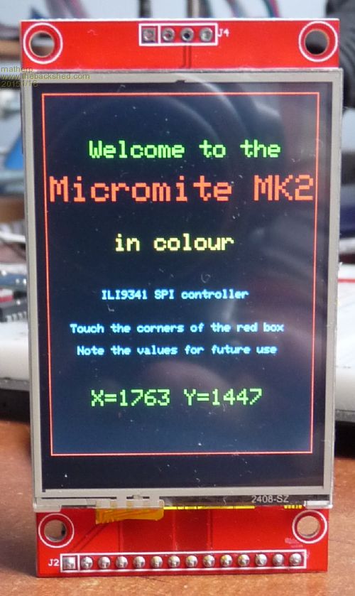

The SPI version of the ILI9341 touchscreen arrived yesterday so I've modified the various routines to make it work and fully implemented the routines to drive the XPT2046 touch controller chip. This all works much better than the analogue touch outputs on the Arduino shields. Both the ILI9341 and XPT2046 are SPI devices so they are both connected to SPIout (pin 3), SPIin (pin 14), and SPIclk (pin 25). Additional pins are used for chip select etc. as follows:
I9341_CS=6 'chip select for the ILI9341
I9341_CD=4 'command/data select for the ILI9341
I9341_RESET=5 'hardware reset line for the ILI9341
T_IRQ=2 'Touch registered output from the XPT2046
T_CS=7 'chip select for the XPT2046
The I9341_CS and I9341_CD pins are fixed as they are used in the cFunctions, the others can be changed in the basic program as required.
Note that the SPI data rate for the display is running at maximum speed (12Mbs). However, the XPT2046 controller can't accept this rate so the SPI clock register is modified in the T.Getdata routine to slow the data for the touch controller and then restored at the end of the routine.
AS always, the code can be used on a 44-pin Micromite by mapping the underlying port/pin combinations using the PIC32MX170 datasheet and changing the basic code assignments to match. The cFunctions will work as-is.
I've also spent time optimising the size of the cFunctions and reduced the font table to just the normal printing characters - this has made a huge change to program size.
There are three programs in the zip file:
2015-01-16_152147_ILI9341SPI.zip
ILI9341ser.bas does a complete demo and test of the graphics and text drawing routines.
ILI9341calibratetouch.bas uses the graphics routines and the touch routines and displays the coordinates wherever the screen is touched. This allows you to note down the maximum and minimum coordinates of the display screen for use in calibrating touch applications. In my case the x coordinates run backwards.
ILI9341touchdemo.bas is a demo painting program using the touch input and graphics routines. Touching just below the drawing area on the left side clears the screen. Touching one of the colour blocks at the top of the screen changes drawing colour. The coordinates from the calibrate routine are used to define the xmin, xmax, ymin and ymax parameters. The software scales the touch position to the screen coordinates to draw the trace including reversing the sense of the raw x-coordinate.
I've also attached a zip file of the c-code:
2015-01-16_155455_ILI9341.zip

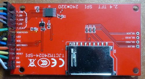

The third picture shows the bottom of the PCB. There is a shorting link just below the small three pin voltage regulator. For 3.3V usage with our Micromites this link should be made to bypass the regulator.
For applications where the size is right, this display is much the most effective of all of the ones I've tried. It updates fast despite being SPI and the touch system is properly implemented using a dedicated controller. Also as both controllers are SPI, pin usage is minimised and there is no use of other special function pins such as COM1 and I2C.

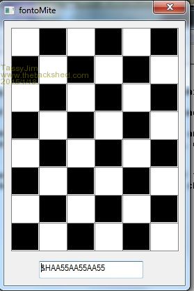

All you need now is "font-o-Mite"
A simple utility for creating those missing characters.
Nothing to install, just download and unzip.
Click on the pixels to toggle them on or off.
The HEX characters are in the lower box ready to copy and paste.
You can also paste HEX characters (with or without the leading "&H")
2015-01-18_052153_fontoMite.zip
Something to play with while I wait for the display modules to arrive.

Posts: 6607
Posted: 10:34am 18 Jan 2015
Glad you like it.
My next task is to take the font data as presented in Peter's cfunctions and swap the order so they display correctly without having to do a manual swap.
That will make modifying characters easier.
I was also considering making it a 4 x 2 display of characters so you can create characters that flow across character boundaries.

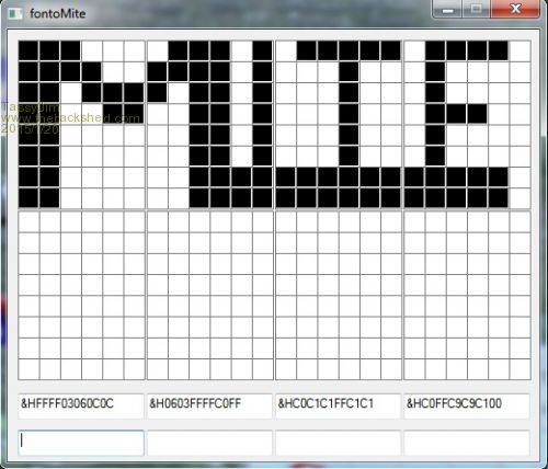

Posts: 6607
Posted: 09:05pm 19 Jan 2015
The new improved version.
You can create 8 characters at once. Useful for high-res characters.
Single click on a pixel to toggle the colour.
Double click to invert all pixels for that character.
Clear the text area to clear the character.
You can cut and paste a number from Peter's font cfunction and font-o-mite will recognise the format. This makes starting with a preformed character easier.
Right click to swap the HEX value from normal hex numbers to the layout used in cfunctions. Useful if you want to paste the altered character back into the font cfunction array.
2015-01-20_065811_fontoMite.zip
