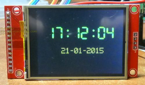

Just implemented in Basic a generic way of using the HenningKarlson fonts
Far too slow to be usable (14 seconds to write this screen) other than for static text and a lot of work to integrate into the CFunctions but I'll try and work on it over the next week or so

Update
Time reduced to 41msec
Posts: 10048
Posted: 01:26pm 21 Jan 2015
That beats the hell out of my "LEDmite" idea!
Good one - keep up the fantastic work. This is a thread I am really interested in now, with the nice big LCD font. I assume you can make the LCD font any colour you like and not just green? I'd be going for red, as it would mimic an LED display then, and also be nice and easy to read from a short distance.
Dropping from 14 seconds to 41mS is exceptionally impressive. With the 14 second one, was that totally in MMBASIC? That's how it reads in your first post. I assume that you have now got the screen drawing routines into Cfunction - hence the new 41mS draw time.
41mS is a very usable screen draw time...

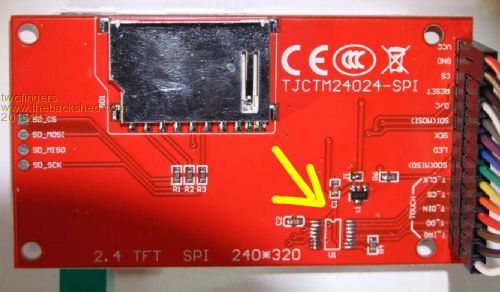

Hi Zonker,
  Quote  Where is a good source to get the touch screen units with the "correct" controller..?
You can buy this displays on ebay (search: "2.4" 240x320 SPI TFT LCD 3.3V SD ILI9341") from china. They will sell it for ~6$.
Michael
PS:
Because SPI names always can be confusing, I made a small PIN-table (not tested yet).
I hope I interpret peters instructions well.
MM-PIN–––––––––––Display
VCC–––––VCC (3.3V)
GND–––––GND
2––––T_IRQ–––––––T_IRQ (touch)
3––––SPIout––––––SDO(MISO)
3––––SPIout-T––––T-DO (touch)
4––––I9341_CD––––D/C
5––––I9341_RESET–RESET
6––––I9341_CS––––CS
7––––T_CS––––––––T_CS (touch)
14–––SPIin–––––––SDI(MOSI)
14–––SPIin-T–––––T-DIN (touch)
25–––SPIclk––––––SCK
25–––SPIclk-T––––T-CLK (touch)

The table above seems to be somehow wrong . Graphics works when I exchange SDO(MISO)<->SDI(MOSI).
Touch functions are not working for me.
Any help or tips appreciated!

Posts: 6608
Posted: 11:23am 02 Feb 2015
  twofingers said
edit;:
Michael
OUT on the micromite should be connected to IN on the display.
I have a couple of those displays with touch on the slow boat from China. I don't expect them for a couple of weeks.
Posts: 11904
Posted: 11:38am 02 Feb 2015
Micromite is the "master", display and touch are both slaves
MISO = Master in slave out
MOSI = Master out slave in
so SPIOUT on the micromite connects to MOSI on the display and visa versa
with the labelling of the touch SPIOUT on the micromite connects to SPIIN on the touch.
clocks work in parallel and each has a separate select pin
twofingers
Joined: 02/06/2014
Posts: 1773
Posted: 12:14pm 02 Feb 2015
Thank you both!
But touch still does not work, with both combinations!
3--SPIout-T––––T-DO and 14–––SPIin-T–––––T-DIN
3--SPIout-T––––T-DIN and 14–––SPIin-T–––––T-DO (should work, but ...)
Does anyone have a working plan please? I'm sure many user will be interested in this.
Thanks in advance
Michael
β€šMy name is Ozymandias, king of kings
Look on my works, ye Mighty, and despair!β€˜
The lone and ...
Posts: 2991
Posted: 12:38pm 02 Feb 2015
I have managed to get several various TFTs and OLEDs working now - just wish I had taken photos.
Can I suggest you go back to getting the graphics working first. Then simply connect the touch wires as follows:
T_IRQ to MicroMite pin (Pin number as defined in the code) Pin 2 by default on a 28pinner
T_DO to MicroMite SPI IN (which is already connected to MISO from TFT)
T_DIN to MicroMite SPI OUT (which is already connected to MOSI from TFT)
T_CS to MicroMite pin (pin number as defined in the code) Pin 7 by default on a 28pinner
T_CLK to MicroMite SPI_CLK (which is already connected to SCK)
The above worked for me
WW

twofingers
Joined: 02/06/2014
Posts: 1773
Posted: 01:24pm 02 Feb 2015
Thank you WW!
Graphics is already working, but touch still doesn't want to work.
I checked each wire 5 times!
Okay, for now I'm lucky with this graphics capabilities.
@Zonker
Looks good! The cheapest are for 6.04$.
Good night!
Michael
This are my connections (touch not working):
VCC––––––––––––––VCC (3.3V)
GND––––––––––––––GND
3––––SPIout––––––SDI(MOSI)
3––––SPIout-T––––T-DIN (touch)
6––––I9341_CS––––CS
14–––SPIin–––––––SDO(MISO)
14–––SPIin-T–––––T-DO (touch)
The lone and ...
Posts: 2991
Posted: 01:56pm 02 Feb 2015
Two questions, twofingers!
1> What software from matherp are you running? Is it definitely the correct touch controller?
2> Exactly what module are you running? (Sorry if previously mentioned)
Finally, do you have a second module to try? This is mentioned just in case you have a faulty one (not that cheap Chinese modules are ever faulty )
