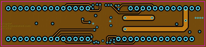

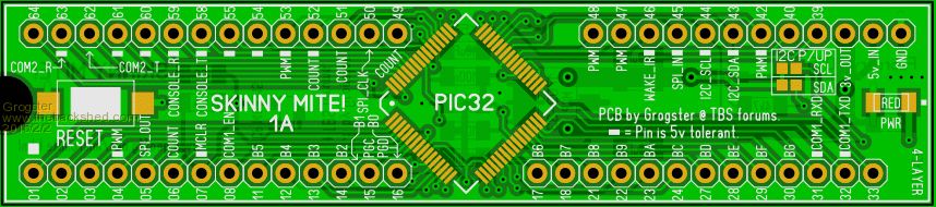

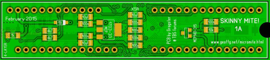

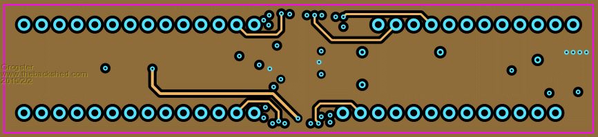

Hi folks.
This is what we have for the SkinnyMite, based totally on matherp's 470 PIC32 idea.
Name changed to something else as per matherp's request, so I started a new thread to reflect that, plus show the changes since the old name for the board.
TOP COPPER:
INNER LAYER #1:
INNER LAYER #2:
BOTTOM COPPER:
The 16-bit port is labelled B0 - BG, using hex-type labeling.
This board has been ordered, and I will let the thread know when they arrive.

Hex for 16-bit port? LOL
That would've been A-F.
Looks like it's got A and C-G with B missing.
JohnEdited by JohnS 2015-02-03
Posts: 10046
Posted: 10:06pm 01 Feb 2015
HOW did I miss that? (rhetorical)
I have sent an email to the factory - I might be able to send them a new ZIP file.
We'll see.

Posts: 10046
Posted: 10:26pm 01 Feb 2015
Shenzhen PCB house this time - we'll see if I get a reply to my email.
Still the same PCB software - Sprint Layout 6.
EDIT: Just got an email from them, and I have sent them an updated ZIP file.
Phew - well spotted, John!
The port is now correctly labelled as B0 - BF.Edited by Grogster 2015-02-03

I am not sure if those GND planes will work like intended. Maybe i not look right but i not see to many places where these GND planes are connected. I see two vias under the PIC and 4 vias on the right.
Normal practice is to have lots of vias connecting the ground planes otherwise you are having ground loops. The size is not too big so hopefully that will not have an effect.
Posts: 10046
Posted: 01:20pm 02 Feb 2015
Good point. This is the first-alpha(1A!) of this board, so for 2A I will add a whole heap more vias connecting the GP's on all layers.
I would not have thought that ground-loops would be much of an issue with the tiny currents we are talking about with this thing, but then, you don't need much current in an old analog microphone circuit forming a ground-loop, to get audible hum - sometimes quite astoundingly large amounts of hum for the tiny ground-loop current flowing, so..........
We'll see. If I get any more done, I will add a whole lot more vias as grounds all over the place where I can fit them, for the 2A version.

Hi Grogster,
the tiny currents are not the problem - but you have extremly fast switching operations today and thereby horrible current changings for all that!!! That's the problem!
Frank

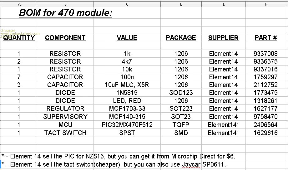

Hi folks. Here is a GIF image of the BOM, so those of you who want to pre-order parts, can get on that phone or email.
I will be uploading a link to a downloadable ZIP file sometime in the not too distant future, which will also contain this BOM as a ODS spreadsheet file, but this will be useful for those who want to order bits, or check their own stock.

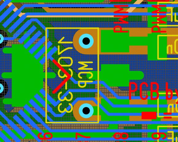

Posts: 10046
Posted: 03:02pm 20 Feb 2015

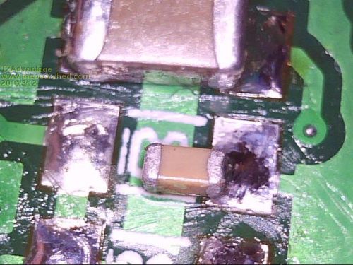

Good news, folks. The PCB's have arrived. I found an error on the freakin' layout around the regulator, so this will have to be fixed by anyone building a board.
As with most things, the 1B version will have this error fixed, and also the new pin legend on the silkscreen, as a couple of pins have changed from the original idea.
It is the 1A version of the board though, so being the very first one, you get right as much as you can, and HOPE there are no obvious errors.
I did, however, miss the freaking link for the input to the regulator:
Note that the input to the regulator(upper most pin on this image), is not connected to the actual input voltage. %!^@!
This WILL be fixed pronto for the next version of the board, but it is something needing attention. The easiest solution to this error at this stage, is to just run a short insulated jumper between the cathode of the schotkky diode and the regulator input, once the PCB is assembled. An annoyance, but an easy fix for this "Mistake".
I say "Mistake", but my own language is somewhat more colourful, as I suppose you can imagine.

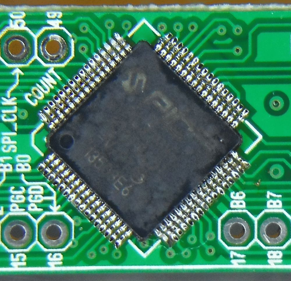

I have finished soldering the 470:
This was technically my first 0.5mm chip(I just lost my 0.5mm pin-spacing virginity!). I have soldered tons of SOIC(1.27mm spacing), and QFP @ 0.8mm, but nothing smaller then that. It was really quite easy - just like the videos on YouTube show you. The longest part of the process, is making sure the chip is in correct registration with the PCB footprint, as 0.5mm pin spacing means you have to be VERY accurate, to make sure that all four sides of the QFP line up correctly with the PCB footprint, or you will get pad-to-pad shorts.
However, that's one down, and therefore the SSOP(on another PCB design) with it's 0.6mm spacing should be just as easy, if not fractionally better.
