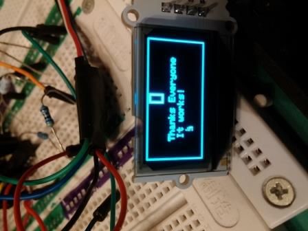

Hello everyone,
I'm new to the Back shed and Micromite and I'm coming over from Picaxe land. With a lot of thanks to Grogster I'm slowing converting some code over. I wanted to add a OLED screen to one of my projects and I bought this one OLED. I hooked it up the I2C pins on the micromite and copied matherp's SSD1306 I2C code in MMEdit and all I get is a blank screen. Any ideas?
Thanks for any help!
Keith
KRZ3
Joined: 31/12/2014
Posts: 39
Posted: 03:33pm 03 Feb 2015
I will add I get
Starting initialization
Using 0.96inch I2C SSD1306
in the micromite chat
and that is all

Thanks everyone for looking into this. I am running the code posted here the 128x64 OLED SSD1306 - I2C. I have a 6V battery to 3.3V regulator. I have 3.2V at the screen. I also tried a separate battery pack to the screen at 4.5V. I have SDA going to Pin 18 I2C Data and SCL going to pin 17 I2C clock, 28 pin chip. I have a 4k7 resistor on both of the lines going to the 3.3V positive rail. I can try the other code White Wizzard pointed out. Maybe it is different than the update one posted. I don't know a lot about the MicroMite or I2C so maybe I'm missing something obvious. I copied the code and pasted it into MMedit. I loaded the code and typed run assuming it would then run the demo code?? In the chat com it seems like it stalls out at OLED.Init i2caddr,0 as it never prints "starting main". I have the other screen they sell too. Same thing without the linker board. I changed the resistors to match the I2C pattern on the back and I get nothing with that as well.

When used for I2C the serial-in and serial-out pins to the display must be tied together, otherwise I2C, where they share a pin, won't work.
The arduino world has produced a hack to allow i2C to work without receiving acks and naks from the slave. This can only be done by bitbanging the I/F.
It is possible that this display isn't correctly set up for i2c in which case you need to mod it. Pins 19 an 20 from the display need to be connected together. I did this on one display which had the problem with a blob of solder. I'm trying to find the reference for the pinout but hopefully the picture will help
I can't think of any other reason why the code wouldn't work if wired correctly.

Sorry - just found the reference. You need to connect BS1 (pin 20 to VCC pin 21) to put it properly into I2C mode as in the picture. Make sure BS1 isn't tied hard to ground without a resistor.

It works! Soldering the two pins together brought it to life.
