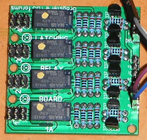

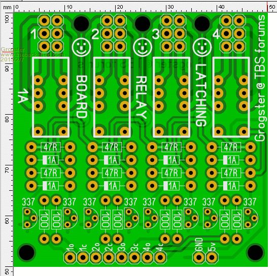

Hi folks.
Here is my latching relay PCB. Lets you control up to four sperate DPDT latching relays on the one board. Full transistor driving on-board, and all relay contacts brought out to pin headers. 50 x 50 PCB size, so nice and small-ish. Each relay can handle up to 2A @ 30v DC per pole.
PLEASE NOTE THAT THIS BOARD IS NOT DESIGNED FOR, NOR SHOULD IT EVER BE USED TO SWITCH MAINS VOLTAGE.
I would hope that members here would know that, but I feel I should point that out, before someone makes the attempt. If you need to switch more then 2A, you can use the latching relay, to switch other more powerful relays - that is actually how I have one of the prototype latching relay circuits setup.
I will be getting some of these made next week(as 2x2 panels), so if anyone is interested, flick me a PM.
All standard through-hole parts(easy to build!), and you can buy the Panasonic relays from eBay - US12.95 for ten relays. Being that these relays are made by Panasonic, they should not be hard to find elsewhere if eBay run out.
RELAY LINK
There is a link to the PDF for these relays, on the eBay link if you follow that.
These relays are actually 4.5v coil, designed specifically for being driven by a transistor and 5v supply.
TOP COPPER:

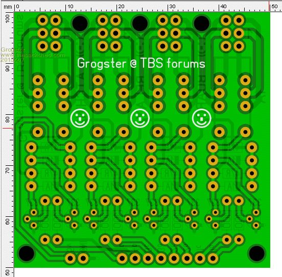

BOTTOM COPPER:

Posted: 12:51am 26 Mar 2015

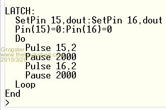

Boards arrived and I finally got a chance to assemble one.
I have been able to get reliable operation down to a 2ms pulse.
Any shorter then this, and the relay fails to latch.
3ms would be a safe figure to ensure correct operation.
Discussions on this thread have convinced me to swap the high-side diodes for plain resistors. Original called for 47-ohm resistors, so I put two 100-ohm resistors in parallel(one where the 47 was, the other where the diode was, which wires them in parallel) to give me a final resistance of 50-ohms or so, which is pretty close to 47.
I still have 39 of these boards, so if anyone wants one, flick me a PM.
US$5 for a board including airmail to anywhere on the planet.
US$10 for a panel of four boards including airmail to anywhere on the planet.
Board only - you will need to populate.
All through-hole assembly.
