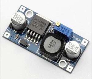

if the project has a similar power budget to the colour maximite, then i'd be inclined to suggest using an LM2596 buck-regulator to get you down to 5v. these can be purchased as a finished assembly complete with capacitors and magnetics for less than us$1 each on ebay (including delivery). see here:
http://www.ebay.com/itm/400595983355
the next step, to go from the 5v down to 3v3, i'd follow what others have said and use something like the TC1262-3.3 that geoff uses on the maximite. the output of this specific device is tightly trimmed, ensuring (when a micromite or maximite is powered) that the accuracy of analog signal measurements are maintained.
the rationale for the mixture of technologies is as follows:
the LM2596 is good for up to around 30v at the input terminal, and can deliver a couple of amps output. because it is a switching regulator, it will step this down to 5v with around 80% or so efficiency irrespective of the input voltage. hence, little heat dissipation.
the TC1262-3.3 is a good choice for going from 5v down to 3v3 because of precision regulation, low noise operation, and simplicity of design. while it will only be around 65% efficient, this matters much less for the smaller step. also, it is likely your current draw from 3v3 will be far less than that from the 5v rail. wherever possible, try to run things like relays and LEDs off the 5v line to help keep the 3v3 regulator lightly loaded and running cool.

MicroBlocks
Joined: 12/05/2012
Location: Thailand
Posts: 2209
Posted: 04:56am 21 Feb 2015
Rob,
How do you get those efficiency numbers?
It is one of those important numbers that is often hidden.
Posts: 2552
Posted: 05:34am 21 Feb 2015
  TZAdvantage said   Rob,
for the LM2596 i pulled the number out of thin air - it was an educated guess based upon past experience with similar PSU topologies. as it happens the guess was pretty much spot on. see the graph near the bottom of the following page:
http://www.ti.com/product/lm2596
from 12v to over 30v the graph shows a typical efficiency (with 5v output) of a tad over 80%, while the efficiency still remains above 75% as Vin drops down to a 7v low. btw, in practice i'd be reluctant to rely upon a (Vin - Vout) difference of much less than 2v.
the efficiency will be affected to some degree by the choice and quality of components, but shouldn't deviate markedly from the above figures.
the efficiency of the 5v to 3v3 regulator is simply (Vout / Vin), or 3.3/5 => 0.66 (about 65%). there will also be a tiny loss due to the control/ground pin current, but in most regulators these days this is extremely low. just checked the TC1262 datasheet - 80uA.
rob :-)Edited by robert.rozee 2015-02-22
Posts: 6608
Posted: 10:32am 21 Feb 2015
I tested some of those ebay switchmodes and under no load, they draw about 11 mA from 12V.
I also prefer the switchmode to 5V followed by a linear 3.3V regulator.
