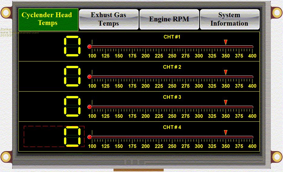

So, maybe order the DuinoMite-Mini Board from Olimex to use as the prototype and then get this going... I want to use this as a protocol converter to listen to the Rs-485 buss to receive data for the objects on the 4-D Systems 7" touch display used for my EIS system I am developing... The Duinomite also has the SDcard interface on it to store the "CSV" based log files being stored to keep track of the engine data collected during the flight of an ultralight aircraft... Logged data will consist of CHT, EGT temps, RPM, battery voltage and the like... Still working on the different parts of the system... This part will be one possible "display device" the pilot might choose to install...
There are other types of displays we are designing, one involves using a MM to drive very small servo's to create "old-school" style instruments if wanted... My friend ED (the guy with the 3-D printer) is creating the gauge casings and face plates for them... All displays will listen to the Rs-485 buss to get there data... The "front-end" module will be collecting the engine parameters and send out the Rs-485 data packets... I am thinking to using the LTC2983 from Linear Tech to get the temp data from the thermo probes... this is an awesome IC that uses the SPI port to transmit data and commands... This project is bigger that I first thought... Edited by Zonker 2015-03-02
