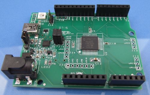

CircuitGizmos
Joined: 08/09/2011
Posts: 1427
Posted: 08:02am 04 Mar 2015
Want one of the prototype Arduino-shaped boards?
PM me.

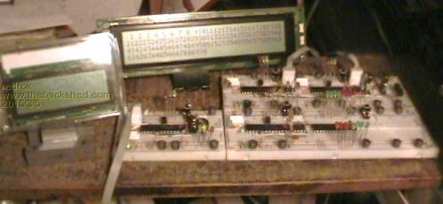

redrok
Joined: 15/09/2014
Posts: 209
Posted: 05:05pm 04 Mar 2015
Hi Tyler;
  tylercook said   I was considering doing that, but figured there might be a board out there already. If not, then I will go with this. Thanks!
Would something like this work?
I thought I would put a plug in for the Plug Board uMites.
There are 6 uMiteIIs here.
The bunch on the right and the 2 LCD displays run as Slave IEEE485. Mostly as software experiments. And 3 RTCs.
All the LED indicators are the LUMEX SSL-LX3044 12V LEDs with built in ballast resistors. They are very handy on plug boards. A tad spendy at $25us/100. They come in 3 colors. I prefer the 12V types as they draw less current than the 5V versions and are just the right brightness all the way down to below 3V. Cool huh!!!
Sorry about the crappy picture, I didn't have a good camera handy.

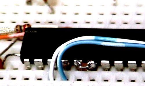

And here is how I added a nice surface mount 10uF ceramic cap to the 1.8 volt pins.

CircuitGizmos
Joined: 08/09/2011
Posts: 1427
Posted: 08:24am 05 Mar 2015
  WhiteWizzard said
Circuit Gizmos 'Arduino'Mite looks very interesting but I haven't personally 'played' with one of these yet. (CG - have you fixed a price/date?)
I'm done testing the prototypes and I have some that are unbuilt that I can build up and part with. I can't compete price-wise with the Arduino that is built by the 100,000s, and I'm gonna lose anyway on the prototypes. But I don't need the extras that I have and I may as well sell them for $30 to recoup a little of the cost.
The production models will be a little different, and hopefully at a price I can make $ on.
