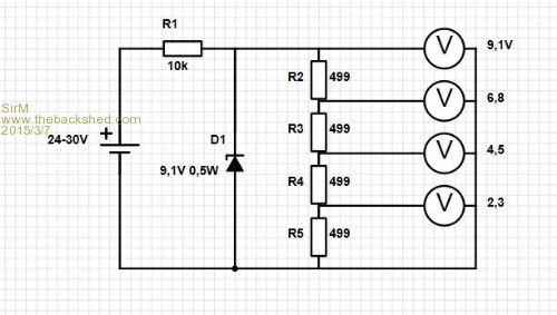

Hi all
Am I thinking right here?

@Sir_M
Nothing wrong with your circuit. What is the purpose for?

Hi Sir_M;
  Sir_M said   Hi all
No.
The four 499 ohm resistors in series draw quite a bit of current. So much so there will be none left to go through the regulating zener.
I would suggest raising R2...R5 to 2K each.
Or
R1 can be lowered to 2.5K any you can still use the 499 Ohm resistors.
R1 will need to be rated at least 1/4 watt.

@Boss
Thanks for reply. Basic programming is much easier than basic electronics
Its for using a 0-10V analog input on a PLC for setting parameters with a dip-switch. The zener is for stabilize the voltage so I know that the resistor/voltage divider givexs the right input regardeless of source voltage (between 24-30V).
/ J
@Redrok
Ah, got it. Better to raise 499 to 2k to keep the overall consumption/heating as low as possible.
/JEdited by Sir_M 2015-03-08

I recalculated your circuit. Basic design is O.K. but :
(24V-9.1V)/10kOhm=1.5mA
1.5mA*500Ohm=0.75V which is wrong, you have to increase current at least 5mA that means @24-9.1)/.005=2700 Ohm (2k7) resistor
Sorry for confusion,
Bo

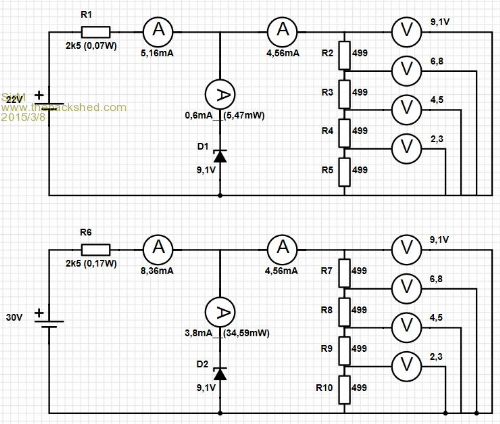

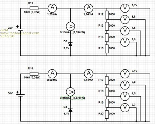

Posted: 04:26am 08 Mar 2015
@ Grogster
Started with just a solution among others.
Now it have become a basic school in electronics for me.
Wonder if I´ve got it right this time...
/ J

Hi Sir_M;
  Sir_M said
Wonder if I've got it right this time...
Yes, you have it right.
I might suggest you change the 2.5K to 2.4K because 2.4K is a standard 5% value.
