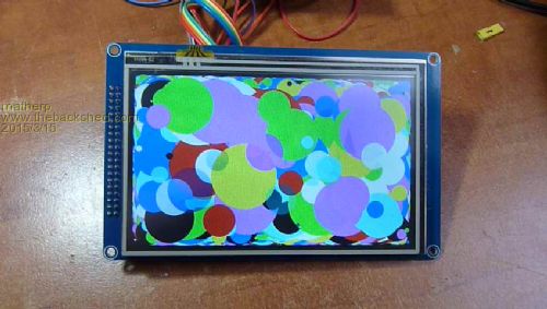

With Geoff's agreement I've implemented various graphics drivers as part of the core Basic language on the ARMmite
You can see the demo on YouTube
The code running this is:
dim integer BLACK = &H0000 ' Color definitions: 16 bit (RGB565) colour palette so these are just examples
dim integer BLUE = &H001F
dim integer RED = &HF800
dim integer GREEN = &H07E0
dim integer CYAN = &H07FF
dim integer MAGENTA=&HF81F
dim integer YELLOW= &HFFE0
dim integer WHITE = &HFFFF
dim integer x,y,r,rc
dim c(7)=(black,blue,red,green,cyan,magenta,yellow,white)
'controller, command/data pin, WR pin, reset pin, no.bits, screen width, screen height
display open ssd1963,1,2,3,16,800,480
do
x=rnd*800
y=rnd*480
r=rnd*100
rc=rnd*8
if x-r>=0 and x+r<800 and y-r>=0 and y+r<480 and rc<8 and r>1 then circle x,y,r,c(rc),f
loop
Graphics controllers supported at the moment include:
ILI934x - 8-bit parallel and SPI
ST7735 - SPI
SSD1963 16-bit parallel
SSD1351 - SPI
Time to write a complete screen on the SSD1963 (800 x 480 x 16bits) 73msec
The commands supported as part of Basic are:
DISPLAY OPEN display type, parameters: in the case of the SSD1351 this looks like -
DISPLAY OPEN SSD1351, SPIchannel, command/data pin, chip select pin, reset pin, display width, display height
DISPLAY CLOSE
DISPLAY font number, x-coordinate, y-coordinate, foreground colour, background colour, text-string
4 fonts are currently included from the list on http://www.rinkydinkelectronics.com/r_fonts.php
The code includes wordwrap and protection against writing outside the screen area
PIXEL x-coordinate, y-coordinate, colour
LINE x-start-coordinate, y-start-coordinate, x-end-coordinate, y-end-coordinate, colour
CLS (optional parameter colour)
BOX x-coordinate, y-coordinate, width, height, colour, (optional parameter F to fill)
CIRCLE x-coordinate, y-coordinate, radius, colour, (optional parameter F to fill)
TRIANGLE x1-coordinate, y1-coordinate, x2-coordinate, y2-coordinate, x3-coordinate, y3-coordinate, colour, (optional parameter F to fill)
BITMAP x-coordinate, y-coordinate, foreground colour, background colour, bitmap (long long integer giving 8 x 8 bitmap). The code treats this as an array of type char[8]. This is read bit7 to bit0, array-index[0] to array-index[n]. The screen then updates the 8 x 8 box top left to bottom right.
RBOX x-coordinate, y-coordinate, width, height, radius of corners, colour, (optional parameter F to fill)
ROTATE orientation (only supported for screens with hardware rotate support)

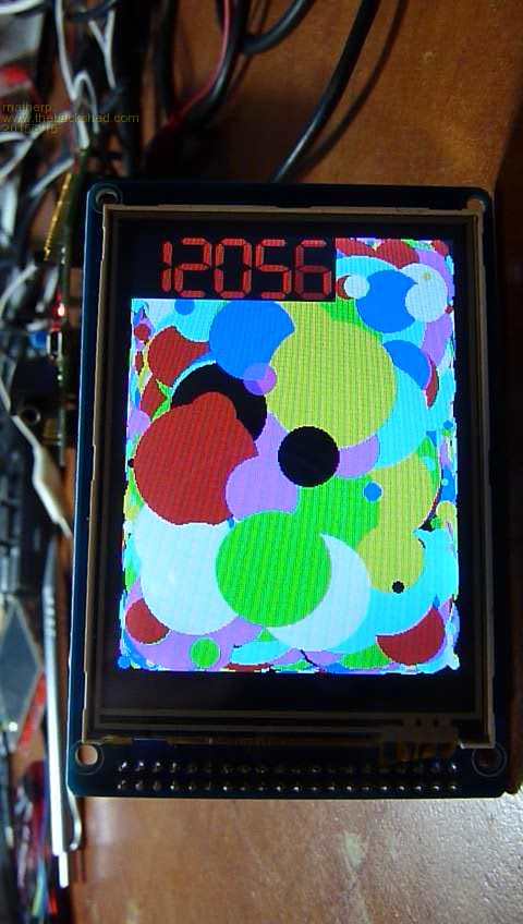

I've just added the SSD1289 display controller to the code. This is the "value" TFT: 3.2in, 16-bit parallel interface, 240x320 resolution.
On this video I put a counter of circles drawn - It is fast 15msec for a complete screen draw and NO CFUNCTIONS needed!

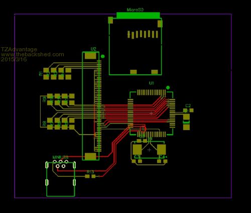

Board in early design.
Fits on the back of a 2.4". It will run a VT100 terminal. PCB is same width as an arduino uno so that it can be used as a shield. The chip is a PIC32MX470MX512.
This is for a larger project i am working on, but will allow easy addition of a screen to a uMite or any other mcu with serial or i2c connection. (It can be used standalone also.)
2 pins is all you need, and same as Geoff's vt100 it will also act as a USB-Serial.

Posts: 2991
Posted: 10:26pm 15 Mar 2015
@TZA
An excellent looking 'project' there - I can see many uses for this.
What do you 'guesstimate' as timescales for your 'VT100 display'?

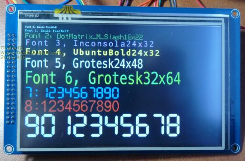

Posts: 11903
Posted: 07:59am 16 Mar 2015

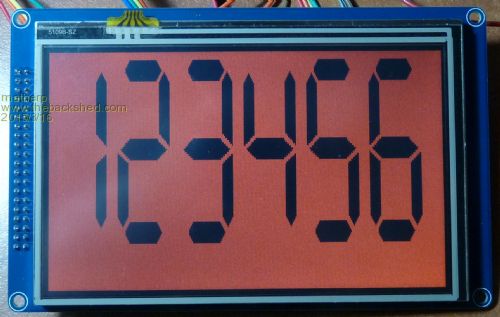

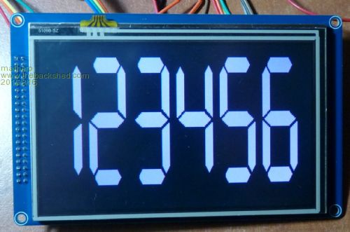

I don't know how many of these will survive Geoff's cull but these are the fonts I've got loaded on the ARMmite - display is the 5" SSD1963 800x480.
The biggest numerical font is 64x100 pixels.
I remember someone was looking for very large numbers for a clock for someone partially sighted - might these do the job?

On using the display as a clock (and assuming HH:MM format), is it not worth going bigger still up to a character width equal to 1/5 the horizontal resolution?
Not trying to create work for you - just think this makes a useful size to have as a potential maximum font size.
Taking things further, I have done some 'teaching' software displaying characters (letters and numbers) one at a time, and in different colours. This is to try teach my kiddies the alphabet (and their numbers) as well as basic colours. This worked really well when each character 'filled' the screen! FYI - I did this on my original MaxiMite and a VGA screen.
So how easy would it be to have a maximum font size (possibly scaled?) equal to the x,y resolution of the screen?
These are just two (valid) reasons in which I have used larger fonts and NOT meant to be taken as a criticism (just a suggestion) . . . .
WW
Posts: 11903
Posted: 09:03am 16 Mar 2015
  Quote  So how easy would it be
Not easy at all!!!!!
The fonts are stored as bitmaps in program memory. The code currently reads these bit by bit in the correct order and writes the relevant colour out to the display which has been configured with a display port set to the size of the character.
It is obviously do-able but the code is pretty tricky. I spent 4 hours today just writing conversion code for the original 6x8 font. This was originally stored as 6 bytes with the bits representing top-bottom and the bytes left to right. I needed the bits left to right to match the other fonts so that bit 6 of byte 0 is the left-most second to the top pixel. My head is still hurting

Posts: 2991
Posted: 09:30am 16 Mar 2015
Must be really hard if you're saying it's not easy
From your photo the characters look really nice and 'rounded' i.e. not scaled. If they are not currently scaled then would a simple solution be to add a 'scale' parameter and hence the 'bitmaps' remain the same but the drawing routing just multiplies up the number of pixels drawn? (I'm sure you know what I mean by this 'bad' explanation').
So for example, Font 2 in your photo is shown as a 16x22. With the 'suggested' scale factor parameter set to 2, then the font drawn becomes 32x44.
This 'scaling' method allows the user to select the appropriate size for their application (i.e. Font 7 scaled by 5 would make a nice full-size clock display).
Only suggesting - but forget I mentioned this if this is still too difficult.

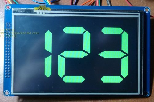

Posts: 11903
Posted: 10:07am 16 Mar 2015
OK, so I lied
This big enough? Just don't ask for anti-aliaising
