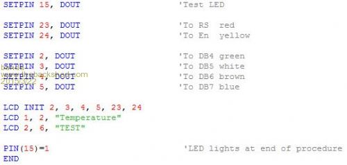

Below is my little program.
It throws up no errors, and the CHAT window shows it has run.

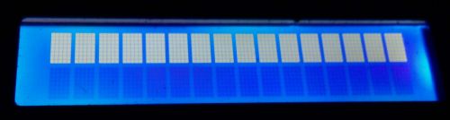

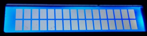

On powerup the LCD shows blue, with one line of 16 dark rectangles. None on line 2.
Nothing changes when the prog is run.
It's a mystery,
banda
SETPIN 23, Dout 'To RS red
SETPIN 24, Dout 'To En yellow
SETPIN 2, Dout 'To DB4 green
SETPIN 3, Dout 'To DB5 white
SETPIN 4, Dout 'To DB6 brown
SETPIN 5, Dout 'To DB7 blue
LCD INIT 2, 3, 4, 5, 23, 24
LCD 1, 2, "Temperature"
LCD 2, 6, "TEST"

  banda said   I've adjusted the pot as high as it can go.
You should be able to adjust the pot and the display will go from nothing (light) to dark.
The setting it needs is somewhere in-between - not fully one way.
One outside leg of the pot goes to gnd, the other outside leg goes to 3.3V and the centre pin goes to the contrast pin on the display.
Posts: 2991
Posted: 09:59pm 20 Mar 2015
As others have said, adjust the pot as it does not need to necessarily be at 'one end' of its travel.
When you adjust it do the 'rectangles' that you mention fade in and out?

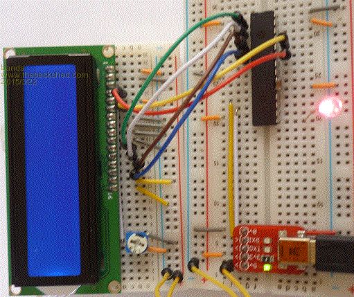

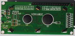

Posted: 01:09pm 22 Mar 2015
All thanks to Grogster who put me on the right track to show pics in my post.
My little prog. The red LED lights at the end of the run program.
The layout, as clearly as I can. The LED is alight.
The underside of my LCD.
Why doesn't the stupid LCD show the text?
Banda
Posts: 10046
Posted: 01:19pm 22 Mar 2015
Hiya.
Can you please post a link to where you got your LCD?
I remember you mentioning that you thought it had a compatible controller, but I would like to check and confirm that for you.
I have not yet examined your images for any layout error, but others will - thanks for posting the photos - they will be of help to me and others.
The only reason I keep asking about the link for this LCD, is I did have the EXACT same problem as you seem to be having, as I was using some LCD's I had here, but they did not have compatible controllers in them. In my case, they were Topway 40x4's, and they worked fine on one PIC project, but NOT on the Micromite - just got the row of black squares you are getting.
The other PIC with the code that DID work with the Topway displays, was not written by me, and was closed so I don't know what they did differently to make that one work.
Fact of the matter is - you MUST have an LCD with a compatible controller if you want to have any hope of it working, so that is why I just want to double check your display for you.
EDIT: I am sure you have read the manual plenty of times trying to get your LCD working, but from the manual:
  Quote  This command will work with LCD modules that use the KS0066, HD44780 or SPLC780 controller chip and have 1, 2 or 4 lines.
So, if your LCD DOES NOT use one of those three controllers, then it likely will not want to work for you - this is why we need to be 100% sure that your LCD does use a compatible controller before we get too deep in the electronic waters. Edited by Grogster 2015-03-23

Posts: 2991
Posted: 01:28pm 22 Mar 2015
Hi,
I believe this is an LCD I supplied - known to be working type.
Looking at the layout there are just two things I am looking at regarding the 10k pot:
Is the 10K pot wired correctly across the supply (two ends of the 10k pot; and is the 'wiper' going to pin3?
The next thing to check is continuity between each pins - check for open circuit either in a lead or a 'bad' breadboard contact strip!
WW

banda
Joined: 12/05/2014
Posts: 35
Posted: 03:42pm 22 Mar 2015
To WW:
When I twiddle that little thingy on the pot the 16 rectangles fade to nothing or brighten to max (which doesn't seem extremely bright to me).

Posts: 2981
Posted: 06:18pm 22 Mar 2015
Hi Banda,
I looked at your link wiring and it looks correct to me.. The one question I ask is the low order bits DB0-DB3 you have linked to GND.. I have always left these floating (presumably pulled HIGH) and that may be your problem..
If you rotate the pot and can see full black rectangles usually on the TOP row only and then can fade them to nothing I reckon the pot is fine... you could rotate till you see the rectangles lit and see if they change to two lines (dimmer) which means the init routine works.
Try pulling the GNDs on the low order data and see how you go. If that doesn't work I would try buzzing from the uMite to the LCD module to make sure every wire is intact.
