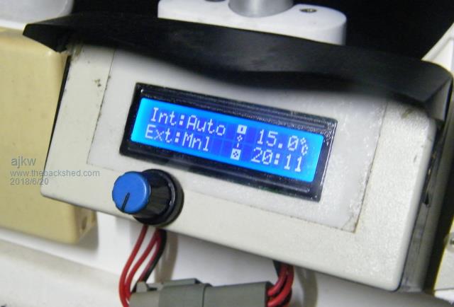

I thought I'd share a little of my MicroMite based project.

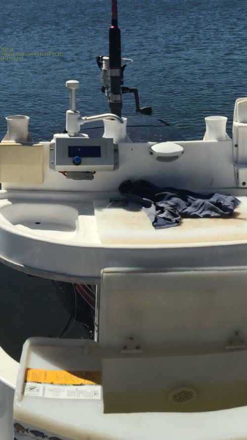

During a fishing particular comp I participate in there is a requirement to weigh fish in alive, this needs a tank with pumps to keep the water fresh. As we also fish into the night for big fish with live baits and they (live baits) also need to be kept healthy in the same tank.
My tank has a internal pump to recirculate the water and a external pump to bring in fresh water, neither pump needs to be on all the time which brings in the MicroMite. My program and hardware set up a fully adjustable auto/on/off timer that controls the pumps while for good measure I have DS18B20 (water) temp sender and a RTC to keep the time. Actually the BTT as I call it didn't get turned off for 3 days and 2 nights so at least the time will still be correct next trip.

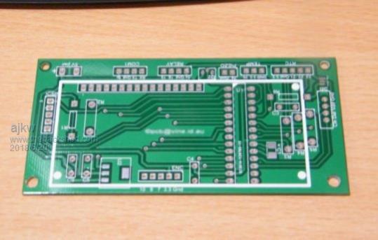

-Create PCB's in software on my PC and have them fabricated. Those boards out of China are fantastic compared to etching your own.

PS. I also learnt those LCD's aren't very sunlight visible.

I have navigation for the boat but a GPS would be useful for the timer in order to turn off the external pump when the boat is travelling, the pick up is out of the water when planning. I have also considered a remote at the helm to set a travelling mode which would be cheaper to do and could utilise the spare I2C header. A cover would work and be easy to do particularly in regards work involved in putting it all the box.

On the water in Port Stephens for the photo, why Orford??

The board was made with AutoTrax Dex, I was interested in the board and didn't tidy up a schematic.

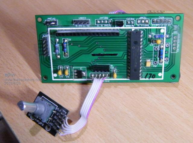

Pin out as follows,
LCD 2,3,4,5,6,14
RTC 21,22,23
Rotary Encoder 7,9,10
DS18B20 25
Mosfet 26 (for backlight)
Piezo 24
Relay 15,16
I2C 17,18
Console 11,12 Labelled Com1
ICSP 1,4,5 - I unplug the LCD for firmware upgrades.
Better pic with a populated board attached. The 4 header just above the encoder wires is just a support for the LCD.
Anthony.

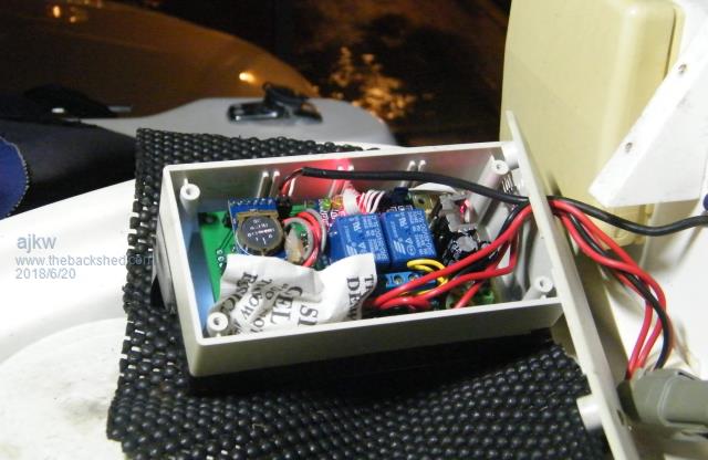

I studied the PCB, as best I could see it, and it all looks nice and clean. My only comment is it looks a little light on power rail caps, I did notice what looks like poly caps to reduce noise and spikes or maybe some are tantalums.
I like the way you have taken the time to label the MM chip pin number on each connector pin label. With that done it is easy to get away without a schematic.
Inside the case picture you posted I spotted the RTC module and relay module and what loos like a small voltage regulator board (maybe boat 12/24v down to 5v). Where they off the shelf modules or purpose built?

Thanks again, I was happy with the board particularly being my first. There are some things I would change if I was to ever get another batch but I have moved onto the SMD backpack's from BigMik for subsequent projects with those nice touch screens.
The RTC (DS1302 in this unit), the relay board and 12v in/5v out power supply are all off the shelf.
There are caps on the 5v and 3.3v rails near the reg and 2 others on the 3.3v lines near the Pic32. The power supply has its own electro caps and interestingly I did have some noise issues on the LCD as mentioned in another current thread. A electro on the 12v supply to the bilge pump fixed that.
