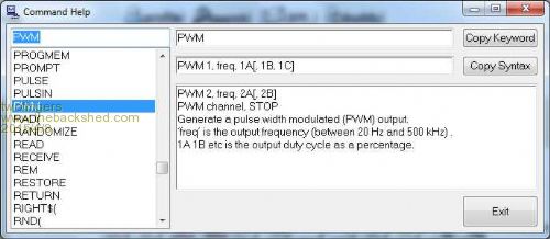

I am confused about the structure of the PWM command. I was currios if anyone could explain how to use it or provide me with an example.
From mmedit
  Quote  Generate a pulse width modulated (PWM) output.
'freq' is the output frequency (between 20 Hz and 1 MHz) .
'ch1' and 'ch2' are the output duty cycles for channel 1 and 2 as a
percentage.
The original monochrome Maximite has only one PWM/sound output so
only 'ch2' can be set on that model.
How do you specifie pins? mkII has pwm 1a,1b,2a,2b,and 1c What is the difference between a,b,c?

uM Manual p.12
  Quote  There are five PWM channels in two groups and the frequency of each group can be set independently
The pins on a 28-pinner are 4,5,6 (PWM 1a-1c) and 26, 24 (PWM 2a+2b).
  Quote  What is the difference between a,b,c?
Geoff only knows! I guess there is no difference between a,b,c. But you can set the pulse width for any subchannel independently (PWM 1, freq, 1A, 1B, 1C ).
I didn't know about the MMedit-Help till today:
You will find more info on page 54 of the uM MMbasic manual.

As an example:
PWM 1,20000,100,50
This command will set PWM channels 1a and 1b using a 20kHz frequency.
PWM 1a will be 100, and PWM 1b will be 50
Does that help?
