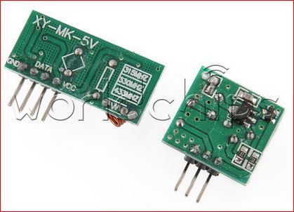

HOWEVER, I think I'm now about to box above my weight because I want to read data wirelessly, sent from outside the house say. I already have a pair of transceivers,
HC-11 433MHz wireless RF serial UART, unused because I defected to micromite,
and as well I've ordered the following,
433Mhz RF transmitter and receiver kit Module
I'm always amazed at how arcane the cross-flow of information is on the forum. It's mostly an alien language to me, so here's my plea.
Is there anyone out there as simple as me (or anyone) who has a simple program that makes transceivers work? I'm good at analysing a working model.
Thanks for ANY advice.

I agree with Bryan on this one, and I have not had a great success rate with those super-cheap RF modules. From what I gather, they DO work, but don't expect it to be easy, depending on module.
I tend to use only Radiometrix or SunrayRF modules, but they are about US$20 each - or more depending on wanted power output etc.
The one major advantage of the more costly modules is that they are more likely to work right out of the box, and will most likely be type-approved.
However, if you wanted to try something with the cheap modules you have, you would need to setup two bits of code - one on the transmitter, the other on the receiver to form the data link.
Most "Dumb" modules(modules that have no processing on-board, they just transmitt the data sent into them) will tend to need some pre-amble bytes to help sync the data-slicer in the receiver end of things. This is normally done with capital U characters, as this represents 8 bits of alternating zeros and ones, which allows the data slicer to sync to the data stream. You also tend to need some kind of qualifier in the data, so the receiving end knows the message is for it.
So, you might have something like this in your code:
TRANSMITTER:
Open "COM1:9600" as #1
Print #1,"UUUUUUUUUUUUUUU$$$$YOUR MESSAGE HERE"
Close #1
In this example, we open COM1 and print the string to it.
The COM1 TXD line is connected to the transmitter module's RXD line.
The module and the MM share a common ground.
The series of U's is the pre-amble, the $$$$ is the qualifier, and the YOUR MESSAGE HERE is the actual message.
RECEIVER:
DO
If LOC(#1)<>0 then
D$=INPUT$(#1,LOC(#1))
If MID$(D$,1,4)="$$$$" then
{what you want to happen with valid message here}
Endif
Endif
LOOP
This receiver code will go around and around waiting for something to arrive in the serial input buffer - this is the line connected from your receiver module's TXD pin, to the MM chip's RXD pin - remember that unlike I2C, serial comms lines cross over from one end to the other: RXD to TXD, and vise-versa.
If LOC(#1)<>0 then - this asks the MM to go to the next level of processing IF and ONLY if, the serial input buffer has something in it for attention.
D$=INPUT$(#1,LOC(#1)) - This code asks the MM to suck however many bytes may be in the buffer, into a string called D$.
If MID$(D$,1,4)="$$$" then - This line of code looks for the qualifier, and if the message does NOT start with that qualifier, then the message will be ignored.
Note that we totally ignore all the U's in the receiving code, as the purpose of the series of U's is not for actual data purposes, but to sync up the receiver to the data stream, so that we CAN suck in the wanted data from the link.
Also worth noting is that smart modules don't need these U's - the first modules in your photos look like this type, but I don't have any of those.
This is a very simplistic look at how to drive RF modules just so you can see how it can be done, but I can help you if you like - I have done a lot of RF module work with the MM and Picaxe chips.

1) SHOULD do it's thing. The code examples I gave are just that - examples, and might need tweaking depending on what your modules can do - many cheap ones are unhappy at 9600 baud, so you might need to change that to 2400 or something with the "Dumb" ones.
2) YES - U's sync the data-slicer in the receiver(for the dumb modules), and then are totally ignored. With dumb modules, you will find that you really HAVE to use that preamble, or you will not get the message, or will be missing bytes from the message. The $$$$ is, again, an example. The qualifier can be whatever you like, but keep it short.
