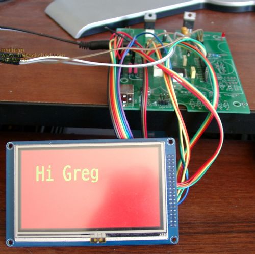

Peter - what socket/connection are you using to break out the 40 pin FPC connector on the 4.3" screen that you linked to with the MX470 B16 firmware update post today.

Do you mean this elegant and sophisticated interconnect

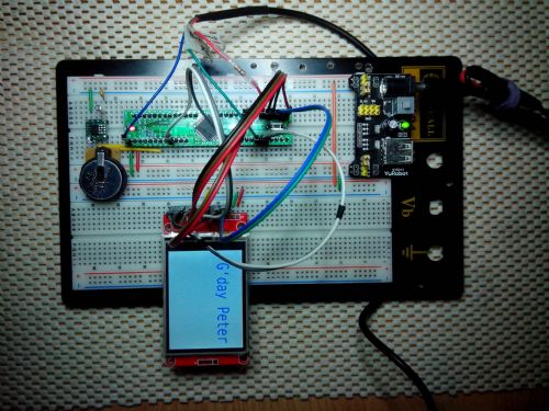

Truly a thing of beauty Peter - and since you've shown me yours I'll show you mine. The little board and button is my pinboard transferable PFC8563 RTC with battery backup.
I was wondering about the connector to the 40 pin flexible coming out of the screen you linked to though which isn't broken out. The screen in your photo above is already PCB mounted with the flexible broken out (to 0.1" headers??) and I'm wondering how best to connect others that just have the flex connector and no PCB.

On a different subject - is there some fairly minimal (i.e. not the full range) colour pallette Vs hex no. available for the 2.4" screen with the ILI9431S controller?
Just for fun I've included some code below showing a simple updating clock on the 2.4" screen. Just demonstrates how simple you've made the graphics.
Greg
'Simple Clock
'Firmware - MX470 MMBasic V4.6B++b15
CPU 96
DIM INTEGER BLUE = &H001F
RTC GETTIME
DISPLAY OPEN ILI9341S,1,11,3,2,240,320
CLS black
ROTATE 3 'landscape, J2 pin1 at top
SETTICK 1000,update
DO: LOOP
SUB update
DISPLAY 5,40,40,blue,black,DATE$
DISPLAY 8,0,120,blue,black,MID$(TIME$,1,5),2
END SUB

BTW - Did you notice the little 1K resistor in the red wire (console Rx into the MX470), neat eh!
BTW2 - that photo setup of mine is using the 2.4" screen of course.

  Quote  I was wondering about the connector to the 40 pin flexible coming out of the screen you linked to though which isn't broken out
On the SSD1963-based displays the controller (i.e.the SSD1963 chip) is on the PCB so without that nothing will work. The PCB also has the touch controller if that is relevant for a particular application.

Yes the link you gave this link says that it includes the SSD1963 controller but there is just the flexible 40 pin connector to connect to, not PCB headers - I guess the controller is hidden under the flat back of that screen.
How is the connection made though between the flexible connector(s) and the PCB in your photo above that has them broken out to headers? Is the flexible soldered direct to the unseen side of the PCB or does it have a 40 pin socket there to match the 0.5mm spacing flexible lead pins?

I suspect this display doesn't have the controller - but it is impossible to tell. It certainly doesn't have the boost circuit for the backlight - note it asks for 21V for the backlight.
This one has the boost circuit on the flexible PCB so may also have the controller. You could try emailing the vendors but I wouldn't be hopeful of a very useful response
I bought this one

Ahh.. OK, it makes sense now. The 21v boost circuit was needed for the 5" Innolux AT050TN33 TFT touchscreen used for the TFT Maximite. It was built separately onto the TFT Maximite PCB and a 40 pin SMT socket for the flexible was also mounted on the PCB. The options now like you've mentioned above are a whole lot easier to implement because that 40 pin, 0.5mm connector is tiny - not to mention the software!
