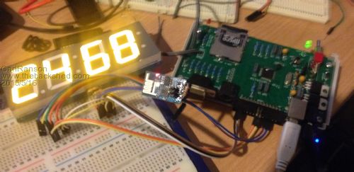

finally got my maximite driving a esp8266 module to act as a tcpip server and drive an i2c based display as well.
I can now send a tcpip packet with the digits to display.
once I've got the code a little bit tidier I'll transfer it to a micromite and make a much more compact unit.
eventually I have a big matrix display to get working for tweets and the like

Yes, it's the adafruit display. I've also got the red,green,orange 8x8 display working. It uses the same driver chip.
As for the ESP, I had to go to the 3rd party firmware which allows the baud rate to be changed as the maximite can't do the higher speeds.
I'll post the code later on when I'm at my main pc

here's the code (such that it is)
The wifi stuff is towards the bottom.
Its really pretty easy with these modules, I found that parsing out the data is the hardest bit.
The firmware I'm using is this one which lets you alter the baud rate.
http://www.electrodragon.com/w/ESP8266_Firmware

  viscomjim said   Hi Carl, do you ever get the "busy s" error from the esp8266 when you are sending or receiving data? What does a typical message that you send to the unit look like? Sorry for all the questions.
I've not done any robustness testing but I have seen the occasional message that didn't show. I want to convert from tcpip to udp so the handshake is simpler. after that I'll write something to give it a good hammering (probably tonight)
the message you get when you fling a tcpip packet at it is like this
0,CONNECT
+IPD,0,3:1240,CLOSED
the 3:124 bit is the data. 3 ascii bytes 123. I just parse out the data and trust I'm getting 1-4 decimal digits at this point.
At this point i'm just using "Packet Sender" by DanNagle.com for driving.

so after some tinkering I've got a reliable result
apparently you can't set up a server for udp with the current AT commands..
I put together some client code that opened the port and sent numbers 0000 to 9999.
without a delay in the client between messages i missed a lot of results and eventually crashed the esp8266.
by raising the baud rate to 19200, and limiting myself to 1 call per second I've got a reliable count-up on the hardware.
before this I was occasionally getting some messages run together. eg. i was sending 1234 1235 1236 as individual messages and getting 123412351236 at the micromite.
so for reliable messaging, you'd need to have a protocol that either prefixed with the length or bounded each end of the message with a unique character.
CarlRanson
Joined: 08/05/2015
Posts: 30
Posted: 02:29am 20 May 2015
so I adjusted my protocol to have [] around each number.
This had the desired effect of not having messages run together when there was a pile-up in the queue, which seemed to happen every now and then.
I set up a server to open the port and send numbers 1-9999 to the display. It seems to get to about 1700 before the ESP2866 crashes.
I get a bunch of "connection failed" messages and then what looks like a reset of some sort on the esp.
is this the problem you hit, viscomjim?

so I've got a client set up to connect with tcpip and send numbers 1-9999 (1 every 400ms). It was getting to around 1200-1400 or so and then having the esp crash.
i found a thread that suggested the reset was a power problem, so I added a big cap across the ESP power supply.
its currently at 6793 and counting...
CarlRanson
Joined: 08/05/2015
Posts: 30
Posted: 11:55pm 20 May 2015
and after a bit of testing its only a partial success.
the esp8266 stays stable for much longer but still eventually fails.
Time to assign it to background processing for a while and see if inspiration strikes

  matherp said  Rock solid reliable.... for over two years
dude, im almost there! this stays good for minutes at a time
CarlRanson
Joined: 08/05/2015
Posts: 30
Posted: 10:03pm 21 May 2015
so I broke out the scope and checked the 3.3v power supply that is running the esp8266 and the display.
I get a sharp drop in the voltage every 100ms. it starts at around -200mv but grows over time. once it hits about -0.5v its enough to disrupt the wifi.
i removed the display and it was still there. removing the esp module made it go away.
So it seems that the ESP8266 module is causing this.
