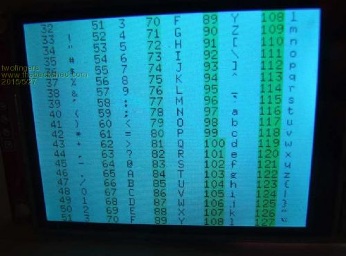

  Quote  The SPI port can also be used within a BASIC program at the same time as it is being used with the LCD and touch controllers.
That's fantastic!
Do you think that we can get an extension of the PEEK function to locate the character set table (to replace some characters using POKE e.g. "°" the degree sign)?
  Quote  CFunctions now have the ability to call some functions within MMBasic.
That's seems to open a new world!
Michael
EDIT:
The chr$(127) looks a bit strange! Or I need glasses. Edited by twofingers 2015-05-28

  Quote  Do you think that we get an extention of the PEEK function to locate the character set table (to replace some characters using POKE e.g. "°" the degree)?
Michael
The font table is in flash so can't be changed with POKE. You can use the Bitmap command to output any arbitrary 8x8 bitmap.
Try
bitmap x,y,&H0000000c12120c00 Edited by matherp 2015-05-28

Hi Peter,
thanks for the quick clarification!
Maybe I can patch the hex file. For your Graphic Library I replaced chr$(127) with the degree symbol. BITMAP can serve as a workaround, I think. But the degree symbol in the character set would be more convenient. I'm lazy! [)]
Michael
EDIT:
  Quote  Try
or
BitMap 10,20,&HFFFFFFF3EDEDF3FF (black on white)
BitMap 10,30,&H0000000006090600
BitMap 10,60,&HFFFFFFFFF9F6F9FF (black on white)
Jims(Tassyjim) font editor (called "fontoMite") can be a tool for creating bitmap patterns. Edited by twofingers 2015-05-28

  twofingers said  The chr$(127) looks a bit strange! Or I need glasses.
No, your eyes are OK. That is a bug, the character is not in the printable character set and therefore should have printed as a blank (I will fix it in the next release).
By the way, in this version unprintable characters will print as a space. I thought that this was more helpful than the previous version which did nothing.
