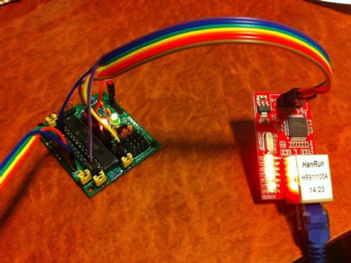

Here is the beginnings of a library for TCP/IP support on the Micromite using the Wiznet W5100 module - readily available cheaply on eBay, eg:
eBay listing for Wiznet W5100 module
This library of functions and subroutines has support for TCP server and client with an example of both. It could be used to run a small embedded webserver, or post measurements to a webserver periodically.
Receiving data from the Wiznet is a bit slow - byte by byte over SPI. It would ideally be rewritten in C if better performance were required. Although, I don't expect many embedded applications would require much in the way of data transfer - short messages periodically only.
The datasheet for the Wiznet W5100 module is available from here (there are later versions around if you search, but figured this should be a reliable link to publish):
W5100_Datasheet_v1_1_6.pdf
There is no DHCP support, only static IP address - the Wiznet W5100 doesn't support DHCP but you could add DHCP support to this library in MM-Basic.
Hope it's helpful to somebody.

yobortsa
Joined: 12/12/2011
Posts: 37
Posted: 11:24am 07 Jun 2015
Hi All,
I've written some brief documentation for the Micromite Wiznet W5100 Library, see below.
David

Posts: 2981
Posted: 12:27am 16 Jun 2015
OMG David,
I wish you didn't create this monster ...
Look what I have gone and done now.
http://mickls.gotdns.org/
PS.. I love it... now to see a list of commands that this module can do... I have had to scrape the last few brain cells from the bottom of my skull to find the correct syntax to display links and pictures etc.. but in a relatively short time... Hey I have a web-server (Almost)
And running on a MicroMite to boot.
Mik

Posts: 2981
Posted: 01:12pm 18 Jun 2015
GDay All,
David has done a pretty good job with his library to the WizNet board..
Now the following could be pretty boring to those who already know this but I post it to maybe assist others get their own WizNet boards live on the net..
Lets get a whole heap of them going around the world..
The above was done fairly simply by looking at HTML code and playing with it in Daivds WN.xxx syntax. I know nothing at all about HTML code and whilst the command syntax is not quite exact it is very close and is basically the " marks in different locations.
I have attached the basic code here if someone was interested in setting up one for them selves.
2015-06-18_225341_mick_webserver_v1.bas.zip
You need to set up a STATIC IP for the WIzNet board (defined in lines 45-48) this should then work on your local network, set these to suit a static IP on your network.
To get the WizNet board to be seen on your WWW network you need to set your Modem/router to `port forward' requests to port 80 through to the IP address of the WizNet module... There are heaps of tutorials on how to do that if you consult Dr. Google.
Now WizNet should be able to be seen externally by using your `real world ISP assigned IP address' in my case (you will have your own set of numbers... Goto myip.dk to see what yours is set to) this, for me, is currently 120.144.191.64 so you can just enter those numbers into your browser from anywhere in the world..
Now, as is the case for me this real world IP can and does change from time to time (such as a restart of my modem or a loss of power etc) so that is where a site like DYNDNS.ORG can help.. you can apply for an acct with them (I think its about $10 per year) which gives you a `pseudo domain name' and then you run a `ticker' on your PC (a small file that sits on your pc to periodically tell dyndns what your ISP assigned IP is and dyndns will update its records and assign your IP to your domain name.. in my case its mickls.gotdns.org so you never need to know what your IP actually is as it all happens in the background.
All that aside my WizNet setup is locking up from time to time, I dont know why, but it seems to be once per day.. I reckon I need to setup a watch dog timer to reset in the event of a lockup/error.
I am going away for about 2 weeks on the weekend so mickls.gotdns.org will probably be offline until I get back.. I may leave it going if I can get a watchdog going.
EDIT***
I have added a watchdog timer to hopefully catch any lockups etc..
If it looks stable I will leave it up whilst I am away.
Edited by bigmik 2015-06-20
