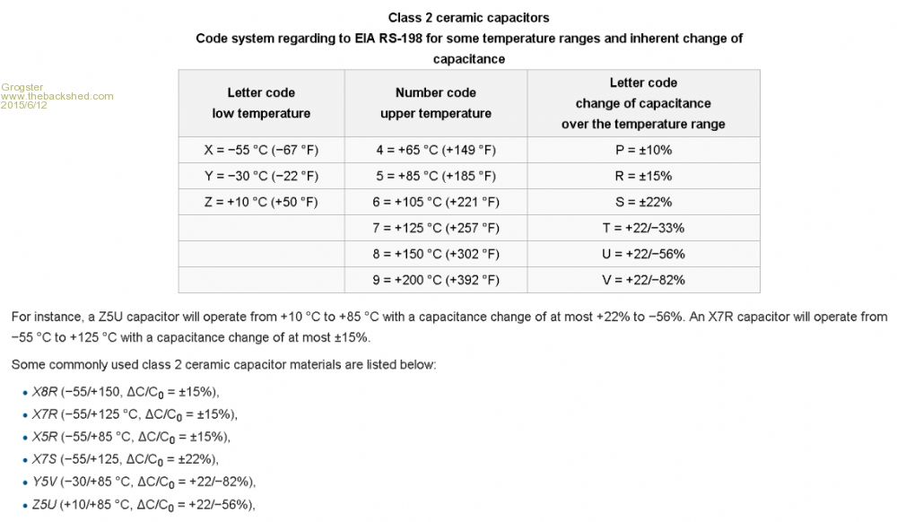

EDIT: Here is a chart to help you choose the right cap characteristics:

Don't get me wrong - nothing bad about akashh's suggest of X7R. It would work fine, but as it is rated for a higher temperature, which you won't be exposing the cap to when used with the MM, then paying the extra for X7R is, IMHO, a waste of cash.
Note how if you were using something like Y5V, then the cap can vary in capacitence up to 82%!!! That is a hell of a lot!!! Yes, it is proportional to the ambient temperature the cap is exposed to, but that still represents a huge amount of change.
