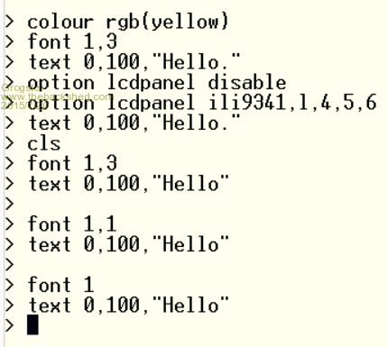

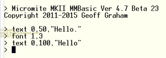

Text display does not want to work for me on an SPI screen, ONCE YOU TRY TO CHANGE THE FONT:
Note that text is fine with the first line of code @ 0,50, but as soon as you try to alter the font scale or select another font, then subsequent text commands produce no output at all. Cls does not fix the problem. Text colour selection does not work either from this point on(although it is fine UNTIL you issue a FONT command).
EDIT: This is on the 170 chip - I have not yet tried this on the 470.
EDIT: Font 2 works OK, but Font 1 does not, so it only seems to affect Font 1.....Edited by Grogster 2015-07-21
Posts: 11903
Posted: 09:40pm 19 Jul 2015
Font 1 on both the MX170 and MX470 is now the 32x50 numbers only font. Font 2 on the MX170 is the only font with a full character set. Fonts 3-6 on the MX470 are also full fonts but not available on the MX170.
This is a change from earlier betas so that the same font (1 & 2) has the same number on both chips. Font 1 will output the space character for any none number.
Edited by matherp 2015-07-21

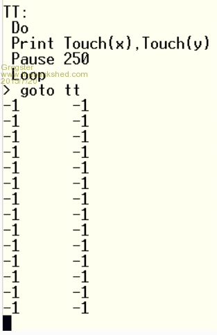

Touch(x) and touch(y) are not giving any results other then -1 when the panel is NOT being touched. As soon as you touch anywhere, the function never returns with an numbers at all. Remove your finger/stylus, and the function returns -1.
Am I doing something else wrong here?
To clarify: if you run this simple loop in the image, -1's start appearing. I would expect that, as the panel is not being touched. As soon as you touch the panel - anywhere - the -1's STOP coming, but there are no other numbers to represent the co-ordinates of the touch no matter what. Touching the panel has the effect of pausing the loop output for the duration of the touch.Edited by Grogster 2015-07-21

Posts: 10044
Posted: 10:21pm 19 Jul 2015
Hi Jim.
Just tried that code of yours, and I get a nice blue clock with red border and green date below, but the clock does not tick, and touching the panel does nothing.
QUESTION: Does the GUI CALIBRATE TOUCH HAVE to complete successfully before these functions will work? No matter what I do, the touch calibration fails. I can touch the targets as part of the calibration and that works fine, but the MM forever reports that calibration failed.

Posts: 10044
Posted: 12:22am 20 Jul 2015
@ Jim - GUI TEST TOUCH results in no display at all - blank screen. This is in direct conflict with my 1963 parallel display on the MM+, which worked a treat.
OPTION TOUCH 15,17 is the command used to setup the touch, pin15 is T_CS on the display, and pin17 is T_IRQ on the display.
@ Geoff - Even with the warning in that accuracy is >8 pixels out, could that prevent the touch from working?
@ palcal - using finger. I don't have a stylus yet, but have a couple coming.
The screen I am trying to use is this one here on eBay, and would seem to be compatible. Touch controller is XPT2046 which is most common, and used on just about all LCD modules from small to big for the touch.
EDIT:
My mistake everyone - all for the sake of one stupid wire!
I had misconnected the T_CLK line to one-pin away from where it should have been, so the touch side of things was never getting a clock line.
Curses!
All working now - funny how you need to wire up correctly for things to work.....
