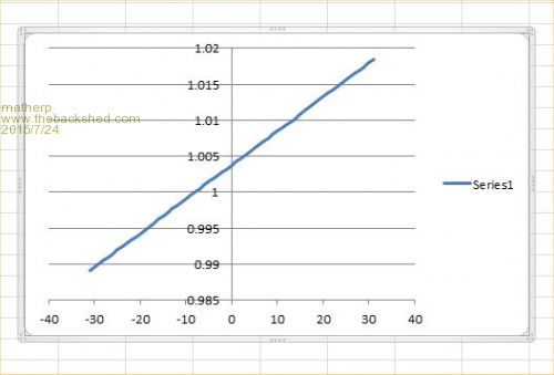

Here is a plot of measured frequency in MHz against clocktrim on my 44-pin part. Bears no relationship to the spec. but a nice straight line.
You can see the where the line crosses the 1MHz at a CLOCKTRIM of -8
Edited by matherp 2015-07-25

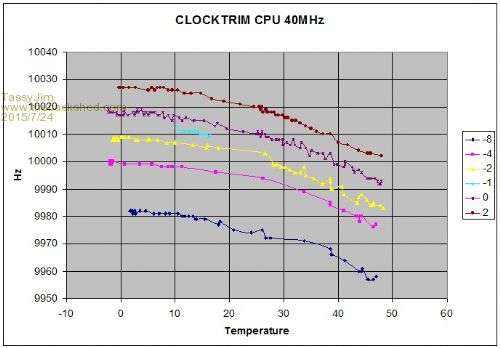

Posted: 01:28pm 24 Jul 2015
I found similar results here.
At temperatures below 20 C, the frequency is reasonably stable.
Higher temperatures will be difficult to manage.
The full test results and the method I used are here:
http://www.c-com.com.au/stuff/Frequency%20stability%20of%20the%20MX170.pdf
