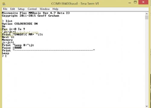

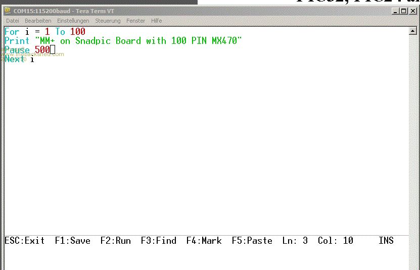

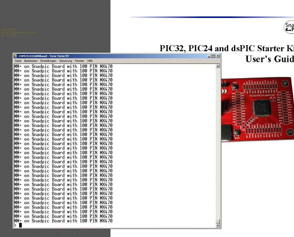

Hi,
my snadpic board arrived today, with 20 mhz Crystal and 100 PIN MX470.
Loaded the HEX File and Basic things work.
Connection is made via usb.
But be aware, that the pinout is different and geoff will make it compatible in future Versions ;-)

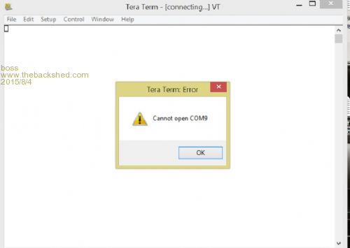

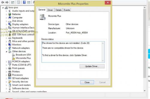

I flashed SnadPIC board with MM+B23 FW, but have no USB console response. Looks like a USB driver is missing on my W 8.1 and the same on W 10.
Any idea where to get MChip USB driver?
Bo
BobD
Joined: 07/12/2011
Posts: 935
Posted: 02:27pm 31 Jul 2015
Bo
This may be what you want.
Bob
2015-08-01_002714_Silicon_Chip_USB_Serial_Port_Driver.zip
Posts: 6607
Posted: 02:37pm 31 Jul 2015
Take note of the problems we have experienced with Windows 10
So far, no joy with the Micromite Plus.
W8.1 has no issues but you will have to disable driver signing to install the Silicon Chip drivers.

Thank you Gents. I'M fighting with fresh Widows 10 installation right now and I realize I have to enable "Unsigned drivers installation" feature. Nice job for Saturday afternoon.
Bo

Joined: 19/08/2011
Posts: 268
Posted: 07:02am 01 Aug 2015
SnadPic is working fine with Windows 8.1 and F8 trick, but not yet success with Windows 10. The W10 say "The best driver (Microsoft) is installed".
Bo
