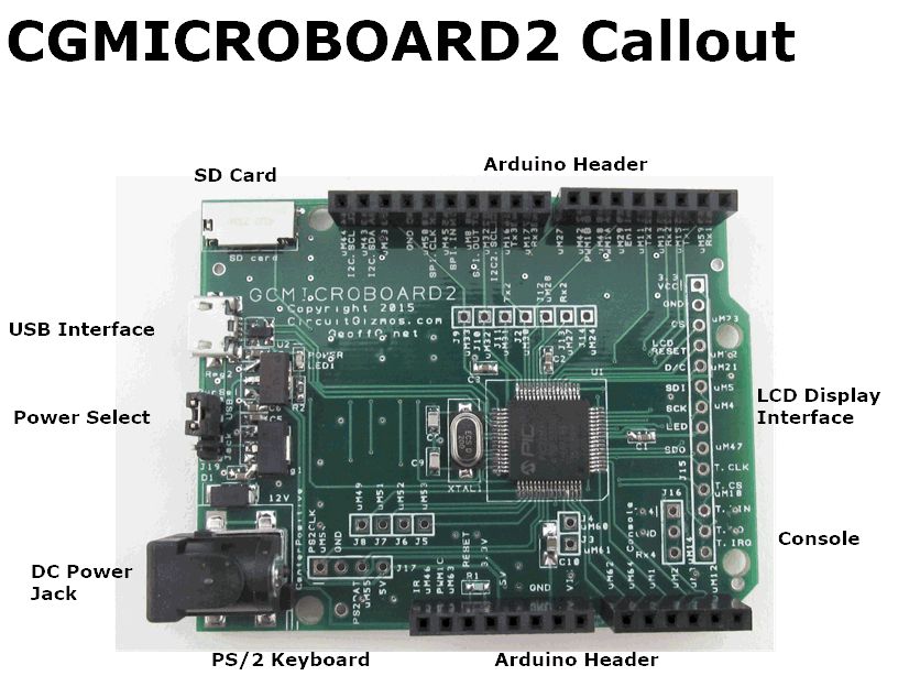

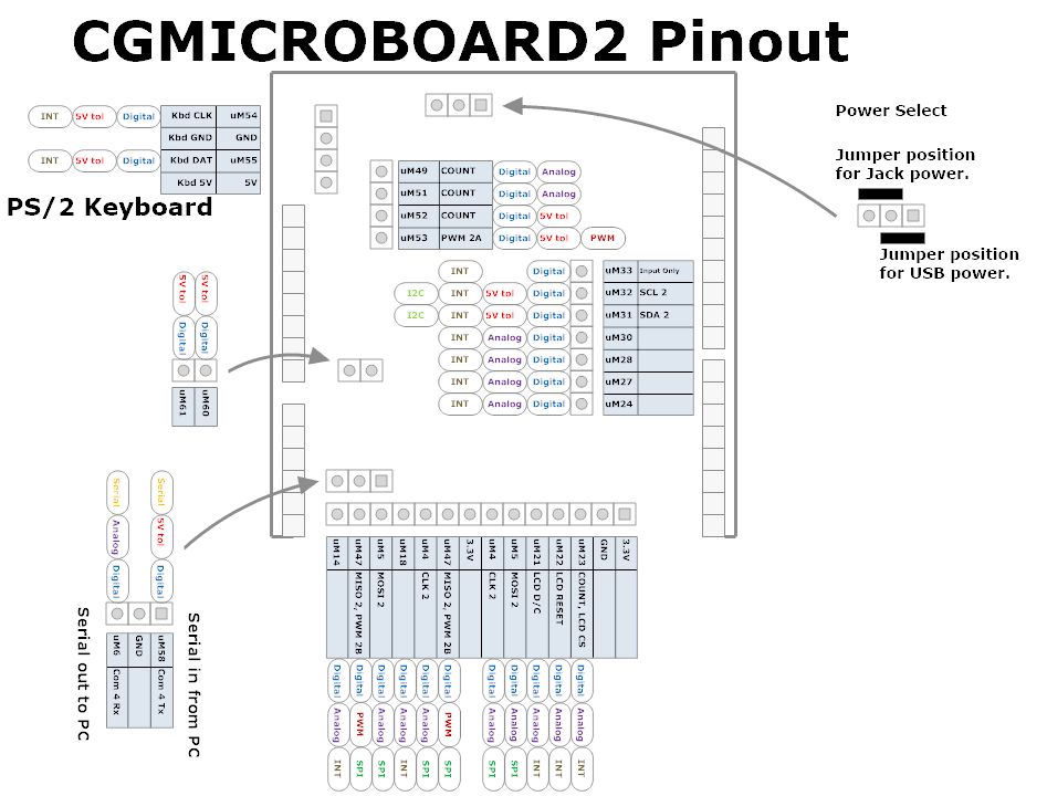

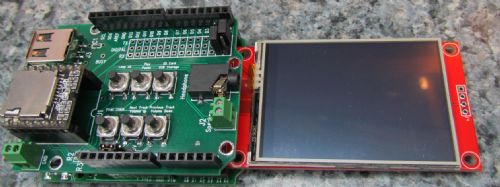

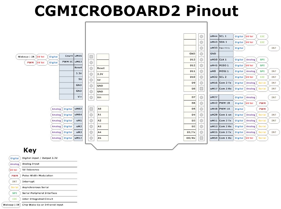

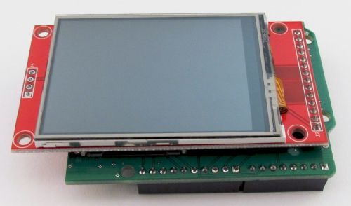

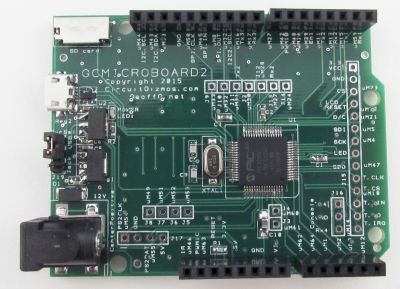

The CGMICROBOARD2 is a Micromite+ based Arduino-shaped board with support for the small serial LCDs.
You can stack most shields on the CGMICROBOARD2 and have LCD access either on the back or front (off to side).
Micromite+ signals were routed to the Arduino headers. There is a header for PS/2 keyboard and one for console. There are extra places to tap into remaining Micromite+ pins. There is also a micro SD socket.

CGMICROBOARD2 Info:

CircuitGizmos
Joined: 08/09/2011
Posts: 1427
Posted: 10:48am 03 Aug 2015
  centrex said   HI CG
Will the production boards have an ICSP header as I dont see one on the current pictures.
regards
Cliff
ICSP is GND/power/reset/clock/data and all of those are available on the Shield headers.

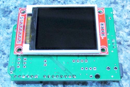

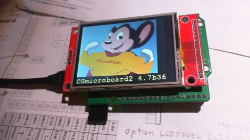

Posted: 11:56am 06 Aug 2015
@Rob..
Ok, Your toy got here today... Jacked it in, and up it came... Looks good so far.. Will update after we get the 2.4" display fitted...
Thanks Rob..!

Zonker
Joined: 18/08/2012
Posts: 772
Posted: 04:58pm 06 Aug 2015
@Rob...
Yep... Works like a champ..! Display popped right on... I used that double sided sticky tape to keep the SD card socket shell from touching anything on the back side and "hard soldered" the unit in place... Sweet..!! Next, the SD card test and KBD test... Humm... I wonder if you can use the LCD console mode and bring up the editor...??? Will give it a go.. Yikes..! bed time...
Thanks Robert... Well done Sir..!!

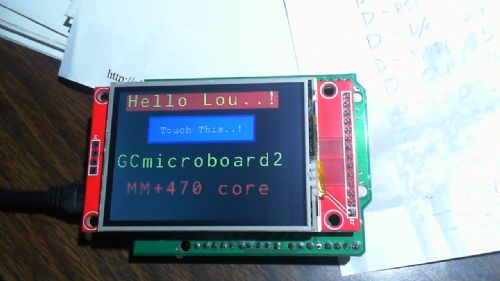

Posted: 08:13pm 12 Aug 2015
CG,
I received your boards a couple days ago, very compact, they look GREAT !!
Zonker is going to outfit one with a display for me to play with.
Thanks CG, thanks Zonker,

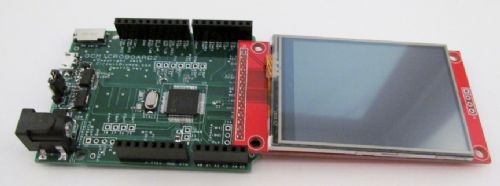

JohnL
Joined: 10/01/2014
Location: Seychelles
Posts: 128
Posted: 07:01pm 21 Aug 2015
Received boards from CrcuitGizmos, Thanks.
Firmware 4.7, Beta 23.
Can't get them to work with ILI9341 2.8" displays, plugged directly in LCD port.
D/C- pin 21, Reset - pin 22, CS - pin 23 as per board description label.
Touch CS - pin 18, IRQ -pin 14.
OPTION LCDPANEL ILI9341, L, 21, 22, 23
Reset board
OPTION TOUCH 18, 14
Reset board
GUI TEST DISPLAY
Nothing, blank backlight only.
Tried with 2 MM+ boards and 2 ILI9341 2.8" displays.
During GUI TEST DISPLAY , can see signal activity with a scope on SPI port.
Any ideas?
