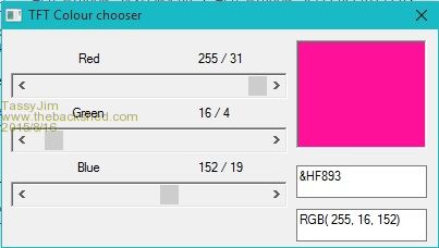

The Micromite colour chooser makes it easy to define colours for the Micromite+ and the earlier 565 colour format.
Simply set the sliders then copy and paste into your program.
The program is a single EXE and can reside anywhere on your PC.

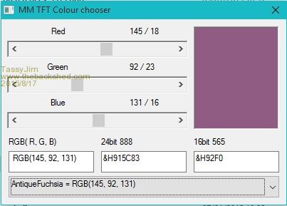

A cold day today so I played inside:
Set the colour by adjusting the three sliders.
You can also enter colour values in the appropriate field. The format required is reasonably loose.
In the 24bit field you can enter:
&H915C83, 0x915C83, $915C83, #915C83, or 915C83h
(HEX assumed because they are all versions of HEX number styles)
915C83 (HEX assumed because there is a character from ‘a-f’ in the number)
9526403 (decimal assumed)
And you will end up with the colour in the image.
In the RGB field, as long as there are 3 numbers with a space or comma between them, the result should be OK.
Finally, you can pick a colour from the pull down list.
Once selected copy and paste the value into your MMBasic program.
In most cases, the RGB field is the preferred one to use.

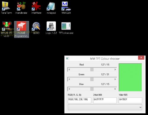

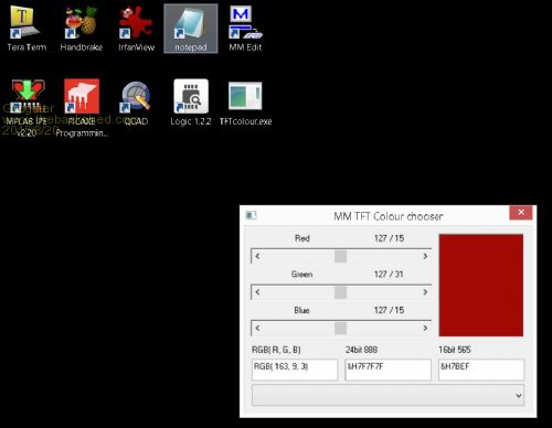

I am having issues with that though - chooser always picks the colour in the icon to the LEFT of where the pointer is - see attached images:

Posted: 02:25pm 19 Aug 2015
@Grogster
I can't see your mouse pointer in the images so it's had to know.
I think you have been clicking.
You don't have to click on anything to see the colour, just move the mouse around.
Use F4 to 'capture to chosen colour.
Most graphics are not pure colours so you do get some odd colours appear. I was going to incorporate a magnifier but I had a few problems getting it to work well with my bits of code so I kept it simple.

Posted: 03:11pm 19 Aug 2015
Hey there - no, not clicking, just moving. Screen-capture shows the icon as clicked.
See this demo video to see the issue I am talking about:
