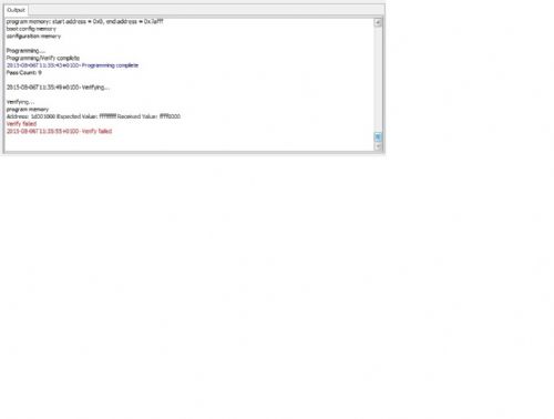

I have now built up two Explore64 MM+ Modules and I’m having problems programming them. I’m using Microchips Integrated Programming Environment (IPE) v2.10 with a Sure Electronics clone PICKit3 programmer. I’ve had no problems with this programmer or software with PICMX150 processors. When programming up the PICMX470 it will Program/Verify ok but when Verify is run it fails. This happens with both modules which puzzles me. I have tried connecting the modules to USB but are not recognised so I’m assuming they haven’t programmed up correctly or I don't have the correct driver. I did check one module out with serial console and it responded ok which puzzled me even more. Any ideas?

The 'Verify' feature has given varying results to people here on the forum - often fails but actually all is ok.
Are you running Windows 8 or 10 by any chance?
If you have a serial-to USB module then connect this to the E64 (5v, GND, Tx and Rx). This will then confirm if the firmware is loaded no matter what OS you are connecting to.
Pins 6 & 58 are the Rx / Tx pins on the E64 respectively. Remember Tx on E64 to Rx on Serial-to-USB module.

I never bother with the verify step anymore - I kept getting those same error reports.
Interestingly, when you program the chip, IPE reports at the end of the programming that: "Program/verify successful." - or something along those lines - I may not have it verbatim.
The point being, that IPE seems to verify as part of the programming process, so I would not bother running the seperate verify step - this is just MY 2c, and others may have other suggestions, or not agree with my logic here.
So long as the program step completes fine, I have never had any issues with units NOT working once that is complete.

Hi Octatron, All,
Yes I discovered this back in the days before the 470 was out.
Geoff replied that this was because on first run MMBasic writes to the memory area and applies some default settings, these, of course, differ from what was just flashed into the chip..
If you want to actually DO a verify then you have to do the following in IPE
Under Settings select Release from RESET
then select HOLD in RESET
Then when you do a flash program you will be able to successfully verify your chip.

I tried Mick's "Under Settings select Release from RESET then select HOLD in RESET" in IPE and now as he says the processor will verify correctly. The bonus is that my laptop running XP now recognises my E64 with TerraTerm after selecting the the appropiate Com port. Thanks Mick.
