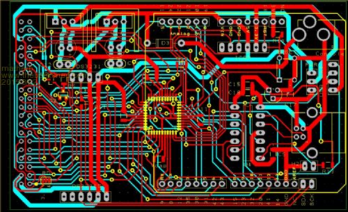

I've now got loadable drivers for the SSD1963, SSD1289, and S6D0164 TFT displays running very quickly using the 44-pin uM2. Peter Carnegie has created SD card routines for the uM2, and I have demonstrated that these can co-exist happily. We have also seen that the PIC16F1455 provides an ideal USB interface for minimal cost.
Given all this, I have designed a simple board that integrates all these components and brings out pins in an Arduino compatible format to allow easy expansion.
I think this should be possible to fit into a PCB about 100 x 60mm
The board is designed to be powered either by the USB cable or a DC input. This is link selectable for simplicity.
The PIC16F1455 is always powered from the USB cable so will not reset with the uM2 or when the DC input is disconnected. This should make the USB connection much easier to manage.
I'd appreciate any feedback on the concept and circuit design.

New schematic and first cut layout attached:

Some feedback i can give is that some of the islands for the resistors and capacitors will make it a bit difficult to solder the components as the traces connected to those islands are thick and will conduct heat away. This only valid when hand soldering.
The islands i mean are the ones for R3, R11, R18, C1, C5, C10, C15 and C18 (maybe i missed one). Best practice is to keep the thick traces for the power traces but branch of a thinner trace to the island.
Any particular reason to use a DIP for the 1455. a ssop is cheaper and i guess it makes routing The blue side) a bit easier and will allow for a better ground copper fill.
Edited by TZAdvantage 2015-08-23

  Quote  Any particular reason to use a DIP for the 1455
I haven't included a ICSP port for the 1455 so it needs programming separately. The DIP format allows it to be socketed during development so it can be removed/replaced.
I've never had an issue soldering with 1oz copper but your point certainly sounds like good practice.
Thanks for the feedback

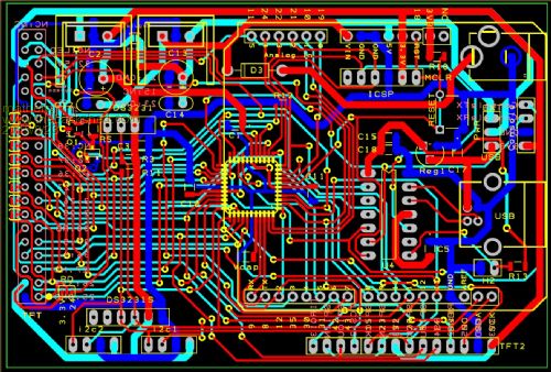

One final version before I go to copper.
I did some testing and the SSD1963 controller doesn't like it when D8-D15 are connected even though it is set to 8-bit mode. To solve this I have had to add shorting links to only connect D8-D15 when required to use the S6D0164 display. This controller doesn't mind when D0-D7 are made if it is in 8-bit mode.

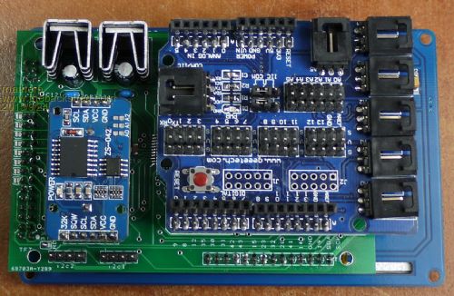

In addition, I have added a header to allow the board to also be used as a backpack for the ILI9143 and ILI9163 SPI displays. This has only increased the board width very slightly (from 61 to 67mm). This left a small amount of unused beard real-estate so I have used the extra space to add two additional I2C headers.
The board is just slightly bigger than a 4.3" SSD1963 display and hidden completely behind a 5" or 7" display.

The PDF of the board layout a couple of posts ago does not appear to be the same as the picture you have shown.
No extra I2C or 14pin header.
Cliff

Ooops - latest version (checked this time ) attached
2015-08-30_102505_backpack44.pdf

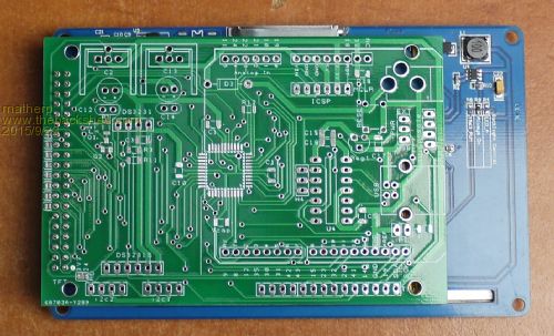

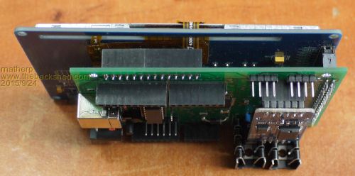

Just received the PCBs. The picture shows one on the back of a 4.3" SSD1963 display. Now to build it up and test it.

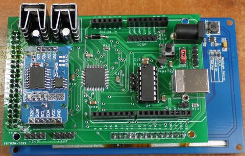

Here it is populated - all works perfectly
Power is selectable between USB and external via the red link. There is separate regulation for the PIC16F1455 which provides the USB console interface (MCP1702-33) and the main 3.3V regulator (TC1264).
The data pins and control pins to the display use the portC pins on the MX170 allowing very fast operation nearly equivalent to the MX470 (CLS takes 25msec on a 4.3" display)
PWM control of the display backlight works perfectly using the onboard npn -transistor/Pchannel-mosfet combination.
Changes for next version:
Connect 5V pin on Arduino header when using USB power (currently only supplied when using external power
Make holes for the heatsink leg bigger
re-allocate pins on the PIC16F1455 to match TZ's default to allow the PIC32 to be programmed via the PIC16F1455 using pic32prog
