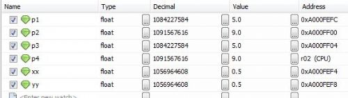

I'm trying to create a CFunction that will look up a value in a 2D table, using bilinear interpolation. If I have table with data points at p1-p4, but I want to get the value inbetween the numbers.
p2 p4
x----x
| o |
x----x
p1 p3
I'm getting stuck on a silly part with decimals on my ZZ calculation. I'm getting the "weight" of where my datapoint is compared to its axis, in the example above, I'm more bais/weighted towards p3 and p4. Using variable xx/yy in my code, which will hold a float value between 0 to 1.
MPLAB just stops while debugging the calculating of zz. "Unknown error while attempting to unwind callstack! User program stopped"
The answer ZZ = 7
If you see of ways to do this faster, let me know. I was it written out to step through the program easier.

Weird, must be a bug in MPLAB. If I don't 'step by step' debug through the math and just let it run, it won't come back with an error.
How does the interpolation look? See any improvements for speed? Once I learn more about assembly code, I'll see how the compiler optimizes this code.

I suggest you PM G8JCF on the MPLAB stuff. My assumption has always been that you can't debug CFunctions other than the old fashioned route with "print" statements because of the way they are loaded into memory and the way on MIPS they are pseudo relocatable code. I've never tried to debug using MPAB, I just assumed it wouldn't work.
The big issue is that you can't do floating arithmetic in CFunctions this way. There are a set of function calls FAdd, FSub, FMul, FDiv, FCmp that you have to use as the normal operators call library functions that are not relocatable. You also need an include file. I will publish something ASAP
