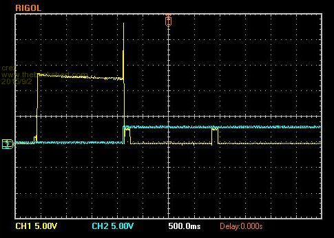

device: OLIMEX PIC-KIT3
operating under IPE v2.25
device selected : PIC32MX470F512H
under advance options: power device from tool.
when I click connect I get two 100ms pulses 1.5 seconds apart of 29 volts on the MCLR line.
Do I have some setting incorrectly set or do I have a faulty PIC-KIT?
two dead mx470's so far...

When you selected PIC32MX470 did the system load the PIC32MX firmware to the programmer? The pickit3 needs differnt firmware depending on the target chip. It sounds like the programmer is operating in a mode for one of the early PICs that needed a high voltage on MCLR to initiate the programming sequence. However, even for these the voltage shouldn't exceed 13.5V maximum.
Try using one of the dead chips but use external power for the PIC and then measure the voltages. You do have VCAP connected and some 0.1uF caps between VCC and GND near the processor?
Difficult to diagnose remotely but it sounds like a faulty PicKit. The genuine Microchip programmers aren't very expensive and I have found them to be very reliable

Sound to me the pickit 3 clone is very faulty, like one of the feedback resistors is open. I would not be looking to use it for any PIC without really troubleshooting this. A pickit should not ever produce that sort of Vpp output under any normal operating condition...

The MCLR(yellow) and VDD(blue) pins of the programmer do this:
but the 13v peak only happens on the first CONNECT command after the USB is connected. Subsequent CONNECT commands behave as they should. These readings were taken with nothing connected. With a 4k7 load on the MCLR to GND, the peak is much shorter but still way over 3.3v
As a precaution I have added 3.3v zeners between all the lines and GND. I also issued a connect command before connecting the target, and it seems the latest programming attempt has been successful. I also have a arduino mini on it's way so I can try Rob's method.
