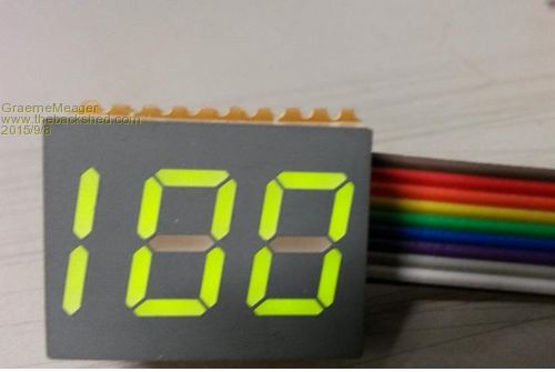

I was thinking and IIRC 2-1/2 digit led displays were used for the cpu speed readout on the early clone AT pc's. If I used one of these I could extend the range by another 100 degrees for the use of one more spare pin on the mmite.
I wonder if these 2-1/2 digit seven segment leds are still readily available or if there is any chance I might find one that I have removed from a case before disposal in the many, many boxes of historic components that I have collected over the years.
GM

Found one.......
After an extensive search of the workshop I located the said items
And guess what? The electric jug does boil at 100 degrees Celsius according to the DS18B20.
GM

But did you check the atmospheric pressure?
Without measuring that the measurements are meaningless.
Only kidding.
It is simple and useful. MMBasic at its best.

Hi Graeme,
Fantastic... I like it..
One question if I may... How do you drive the 3rd digit to get the 1 in 100? You dont seem to support that in your code (at least that my feeble eyes can see)
PS. Remember I still owe you some money/boards so don't let me skip town on you.

@ TZ I know that I am a couple of hundred meters above sea level so being the scientist I am, I compensated and put the kettle on the floor
@ Mick, I will post the amended code when I am back in the workshop.
GM
OA47
Joined: 11/04/2012
Posts: 1051
Posted: 04:41pm 08 Sep 2015
HERE IS THE LOOP MODIFIED FOR THE THIRD DIGIT. THE ONLY PREREQUISITE IS SETPIN(23),DOUT TO DRIVE THE 100'S DIGIT.
TRTEMP=DS18B20(2)
TEMP$=Str$(TRTEMP,2,0)
Print TRTEMP
H=Val(Right$(TEMP$,1))
For J= 1 To 7
If NUM(H,J)=1 Then Pin(D1(J))=0 Else Pin(D1(J))=1
Next J
If Val(TEMP$) < 100 Then
Pin(23)=1
K=Val(Left$(TEMP$,1))
For J= 1 To 7
If NUM(K,J)=1 Then Pin(D2(J))=0 Else Pin(D2(J))=1
Next J
Else
Pin(23)=0
K=Val(Mid$(TEMP$,2,1))
For J= 1 To 7
Next J
EndIf
Pause 1000
GM
