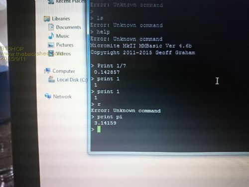

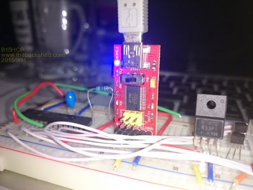

I have a micromite 28 pin from here:
http://geoffg.net/micromite.html
The thing worked perfectly for first few trials. Using a serial connection to talk to it at 38400 baud and I was able to write some code etc...
All of a sudden, the micromite decided not to communicate back to the rs232 chip. So even though the LED's light up, the chip seems not to be responding. Ironically the software that I had written in MMBasic still runs every time I fire up the chip. So basically the chip works but I can no longer talk to it. Is there a way to factory reset the chip or get it back to how it was before?
Just so you know, I tested the rx/tx serial by looping back on itself. It works, so it's not the rx/tx serial board (sparkfun board).
EDIT: Oh and I tried using the rx/tx short method to factory reset the pic32 and that didn't work either.Edited by B15HOP 2015-09-12

Hi BI5HOP welkom to the forums!
Please provide some more details.
Like: Did you get the chip preprogrammed or you programmed it yourself.
Do you know the software version?
Do you have a pickit3 or have acces to one.
Did you set a pincode.
Is the capacitor at pins 19/20 good, is it a tantalum or X5R ceramic one?
I have had problems with good contact before in a breadboard so i soldered the capacitor directly on the pins to get the best contact.
Did you rewire anything before it went incommunicado?
Double check the TX/RX on both sides just to make sure they have good contact.

If the MM talks via loopback, and the 232 converter talks via loopback, then it must either be one or more of the wires, or the breadboard.
Cheap breadboards have been a source of problems for many people - please use a good quality breadboard.
Do you happen to have another breadboard you could test with?

It will help if we know what chip, MX150 or MX170 and what version of the firmware you have on it.
The reset procedure may have changed over time but the manual you hopefully downloaded at the time you acquired the chip will be right for your firmware.
You have tried the usual method (shorting Rx and Tx) but there may be others available.
Other questions are
How are you cannecting the Rx and Tx to the USB-TTL adapter
What voltage is the TTL adapter Rx/Tx set to 3.3 or 5V
If you are running the adapter at 5V and don't have a resistor in the Rx line, you may have damaged the chip but they are fairly robust.

Chip was preprogrammed with Micromite firmware mk2 4.6 (see pic from when it was working)

I unwired all the white wires you see in the first pic and then re connected Tx / Rx to make sure it wasn't those wires. I triple checked pin positions and still no luck.
I'm suspecting the USB cable because when the machine boots, you can see the sparkfun try to send data but nothing comes my way. So possibly it could be the cable. Will try another cable soon. But then that wouldn't make sense because if i do a loop back on tx / rx I wouldn't see a reply huh?
Edit: Cheers for all your help. Still baffled. Still won't reset for me either.Edited by B15HOP 2015-09-12

Hey Jim
Sparkfun is set to 3v3, it has a switch to set either 3v3 or 5v as you can see in the pic it's on 3v3.
Connecting via breadboard but now i'm tempted to soldier to see if that fixes the issue.
Tried shorting rx/tx but that doesn't do anything.

One other (often overlooked) thing for 'new comers' using a Windows environment, is the fact that if using TeraTerm and IF there is a loose cable between the PC and the USB module, then TeraTerm will no longer see the USB module (and hence the MicroMite). You have to re-establish the connection - many ways to do this but the easiest is to use the 'Disconnect' then 'New connection' (both under the 'File' tab).
I have had many customers with 'cheap' USB cables causing this exact problem you are seeing.
The other 'common' issue we see a lot of are 'cheap' breadboards. If you are able to solder the basic setup shown in the manual to a 28-pin DIP socket (just a few connections) then you can eliminate any breadboard issue. Do NOT just assume that a connection is made between two points by 'visually' looking at a wire plugged into the board (or an IC pin!). We have resolved many issues caused by 'open circuits' from poor quality breadboards.
The 28-pin socket idea is a quick way to create a simple 'test' circuit - something I think you will find useful. And IF your PIC is blown for whatever reason, then when you get hold of another programmed PIC you can simply plug it into your already created 'test' circuit.
If you don't have a 28-pin DIP available, then your next best move is as Rob has posted above, i.e. if you have a multimeter then do some thorough testing between device pins and power points.
Make sure vCap (the tantalum) is connected with the correct polarity too (+ve to pin 20, -ve to Pin 19). I assume you have it correct but worth checking as this has caused people problems too.

Posted: 10:23pm 11 Sep 2015
  B15HOP said  As I said the software I wrote still runs on boot (autorun) but I can no longer talk to it...
Is it set to AUTORUN? If so, then have you pressed Ctrl-C to stop your program?

Just to add a bit about breadboards.
The way you use the USB-Serial from Sparkfun is not the best for the breadboard.
Standard header pins are too thick. This causes the breadboards internal metal rails to bend, causing pins right next to it to not make good contact.
When removing the module often those metal rails do not spring back all the way, leaving a row with future connection problems.
Try to buy wires that have a female connector on one side and a male pin on the other side. They are pretty cheap and allows you to use the module in a better position.
Another thing about teraterm that is easy to overlook. Often the serial settings are lost between sessions. Make sure the baudrate setting is correct.
Sorry if these sound silly to you - but we have to eliminate everything to resolve it!!!
I can be online for a while if you are able to respond now . . .
You are my hero. I don't know why I never thought of doing that earlier. Especially since I knew it was like a bash terminal eg VT100. Argh all this stress for nothing :D
I have a big smile now. So happy.

  TZAdvantage said   Just to add a bit about breadboards.
I tested serial plug and unplug and as you say, it stops communicating to the sparkfun board. Since the blue LED that lights up when I type on tera term lights up when there is activity from the keyboard. You are right that if I unplug and replug the connection is lost even though it doesn't appear so from the console.
