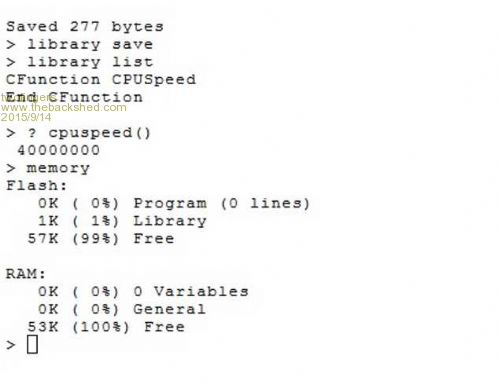

It maybe worth highlighting that when the LIBRARY SAVE command is issued, then it 'wipes' the program from memory (this threw me initially so no doubt others will be too). A sentence can be added to your third bullet point (under 'The LIBRARY Feature')
