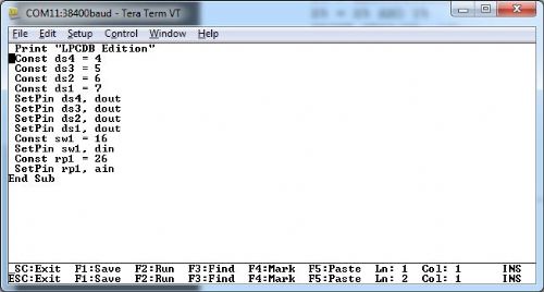

not sure if it is me or if there is a bug in the EDITOR:
if I edit I get this as soon as I press any key:
I did try re-flashing with Beta 30 just in case I had corrupted anything but the problem persists with or without a library loaded and on any program I try to edit.
The second issue is if I run it:
Cheers,
Chris
Edited by Chris Roper 2015-09-18
http://caroper.blogspot.com/

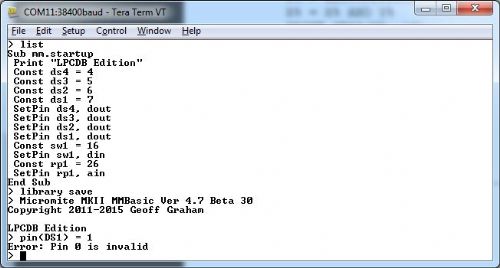

Posts: 2991
Posted: 12:31am 17 Sep 2015
Chris,
If you reboot and then type
? ds1
Does it show 7 or 0?
Also - should be pin(ds1)=1 i.e. normal brackets!
WW

Chris Roper
Joined: 19/05/2015
Location: South Africa
Posts: 280
Posted: 12:50am 17 Sep 2015
  WhiteWizzard said   Chris,
? ds1
[code]
> XMODEM RECEIVE
Saved 226 bytes
> library save
> Micromite MKII MMBasic Ver 4.7 Beta 30
Copyright 2011-2015 Geoff Graham
LPCDB Edition
> ? ds1
0
[/code]
[quote]
WW[/quote]
They are normal brackets, just the low res screen capture makes them look weird
Basically the code runs as the message appears on reset but the constants are being cleared before the prompt loads.
If I include pin(ds1) = 1 inside the mm.startup then the LED lights.
Chris

  matherp said  CONST declared in a subroutine or function only have scope inside that function.
That makes sense so I tried this:
[code]
Const ds4 = 4
Const ds3 = 5
Const ds2 = 6
Const ds1 = 7
Const sw1 = 16
Const rp1 = 26
Sub mm.startup
Print "LPCDB Edition"
setpin ds4, dout
setpin ds3, dout
setpin ds2, dout
setpin ds1, dout
setpin sw1, din
setpin rp1, ain
End Sub
[/code]
and the result is:
> RUN
> ? ds1
7
> library save
LPCDB Edition
[LIBRARY] SetPin ds4, dout
Error: Pin 0 is invalid
I must be misreading Geoff's notes but I certainly can't see a way of using Const and then setting up predefined pins at this stage.
I have built a tray for the MicroMite that plugs into the Low Pin Count Demo Board and am trying to use this to define the LED's etc. in place of the #include file that I use for the PIC/12/16/18 devices in the same board.
Chris
p.s. anybody else having editor issues?
I am having to edit external and then send the file which also hampers testing slightly Edited by Chris Roper 2015-09-18
