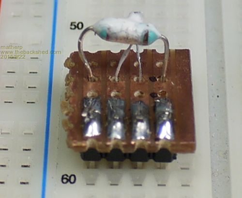

First job was to create a testing environment
So I bonded a 100K thermistor to a 20ohm resistor using some thermal glue. One end of the resistor was connected to +5V, the other to the collector of a 2N2222 transistor. The emitter of the transistor was connected to ground and the base to a MM output pin via a 180 ohm resistor. This gave me a simple "heater"
One end of the thermistor was connected to ground and the other to 3.3V via a 4K7 ohm resistor making a potential divider. The mid point of the divider was connected to a MM input pin via a simple RC filter.
This gave me the measuring input for the controller.
The test system has very little thermal mass and the temperature changes very rapidly with just a slight air movement so should provide a good challenge for the controller.

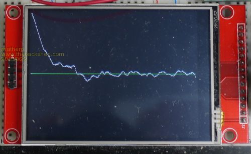

The Basic program uses the thermistor code I have published in a separate thread and is fairly straightforward.

For debugging it was important to see what is going on inside the loop. The PID initialisation had returned the memory address (PIDdata%) of a block of data that the PID control loop maintains in real-time.
"PIDdata%+12" is the location of the counter that it uses to count the 300 msec, so by testing when this wraps back to zero we can do some monitoring each time round the loop.
the subroutine logvalues does this and outputs diagnostics about the operation of the loop. It also plots the error on a display if one is connected (use "CONST display=0" at the top of the program if you haven't got a suitable display connected)
